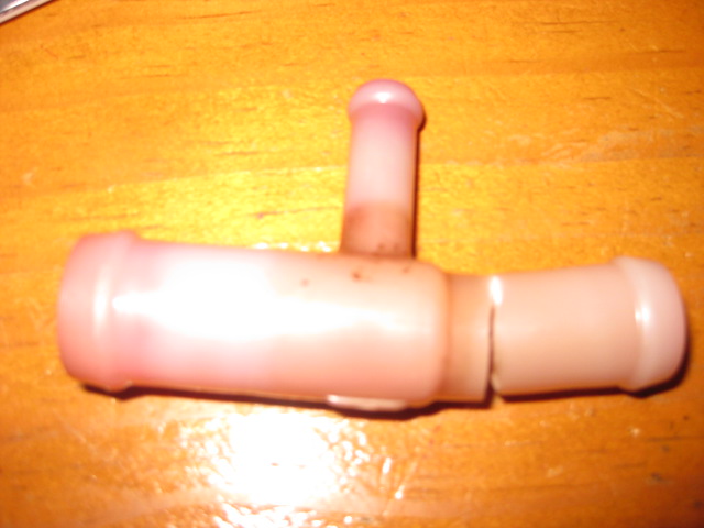

Does anyone have an unbroken fuel tee piece, it connects to the filler neck inside the qtr panel and a fuel vent hose attaches to it and throught he rear of the floor.
I had the same problem. I went to enzed and got a female threaded 't' block, you can then fit the required size threaded barbed fittings straight into the 't' block. It'll be the same size as the original plastic.
