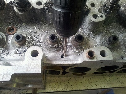

hay Gareth ,,, you got me thinking about water and how every one bangs on about the rear cylinders running hot ...

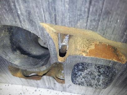

now iv not seen this till now when we tuned the stroker , and made some real power and torque  ,what we seen was no,5 cylinder was hotter and the plug was a lot hotter, and we thought  mmm what should we do and what is the real problem.

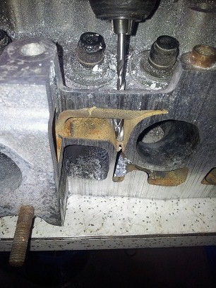

well what to do , get a p90 and cut it up and find how it works ,, and thanks to a good man in Tessie who let me cut a head up we found that there was a casting flash that stoped the water from doing its job .
what happens is the water has a very hard time moving from the hottest spots under the chamber to the outlet ,

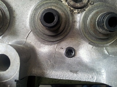

some people have fitted water outlets on the top of the head  and this helps but does not fix the real problem . It just helps not fix, so how do you fix the real problem  well i came up with this .
this with the bleed hose mod lets the water move aroud the hot spot and the motor runs lots cooler and it come up to temp very fast
this mod has to be done to all the exhaust ports ,
:o wow, thats quite the discovery Pete! it looks like you drill in and remove some of the excess casting, is that what restricts the flow round the back of the head? It looks really tight in there especially if those ports are opened up!

iv looked at so many fixes for this and none have fixed the problem all just help , but the water has no path from under chamber it has to go thou very small holes some are blocked and the casting stops the path ,
so this mod with 2 dash 6 hoses to the top of the head , and run to the cold side of the pump makes the car come up to temp much faster and the rear runs at the same temp as the front
