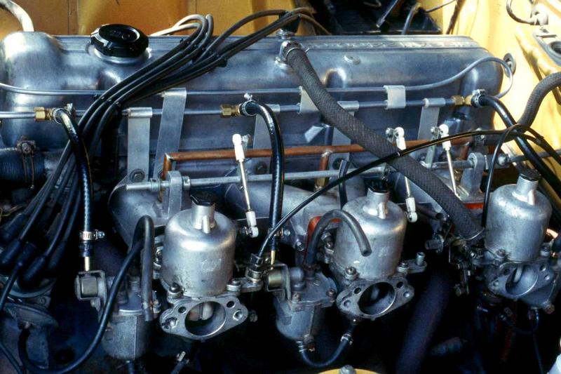

Last year I popped the question re 3 of SU's as a cheaper alternative to the tripple OER's, Mikuni's, Dellorto's, Weber's and what-ever.
NZeder replied that there was information out in the worldwideweb somewhere about it.
I searched around and found Marc Sayer's June 1999 paper at www.zhome.com and it basically said you can have a go, but it will be a dog.

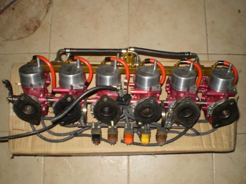

Well someone has done 6 x 38mm carbs and it is also for sale right now on ebay Aust. Check it out!
http://cgi.ebay.com.au/DATSUN-240K-240Z-260Z-280Z-KEIHIN-CARBY-SETUP-/120720309131?pt=AU_Car_Parts_Accessories&hash=item1c1b7dbb8b
Now that's pritty cool

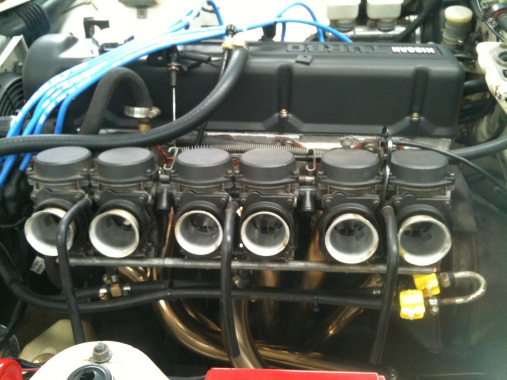

I have 6 x 42mm Keihin carbs cost under $400 plus bit of time.  ;D see pic below
The ultimate setup is done by Vintage perfomance developments in the USA, they do a set of 6 x 45 Mikuni HSR Flatslide carbs..... These babies will out flow 50mm Webbers apparently!  8) They're on Eija's car in the featured rides section. $2095 for the set with linkages, no manifold.
