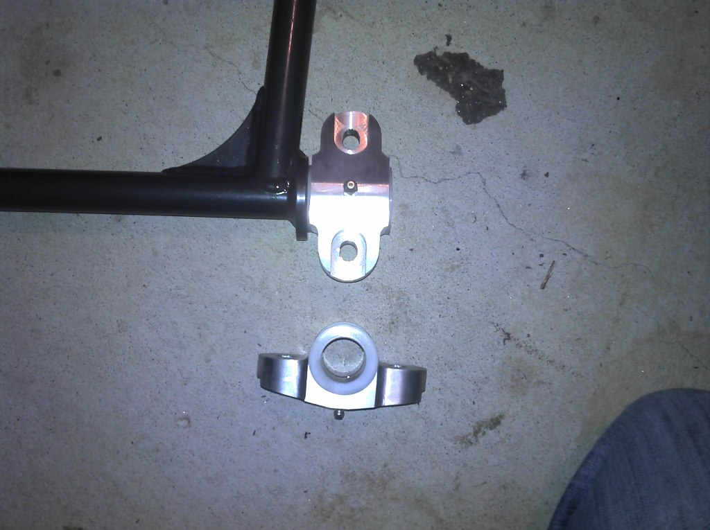

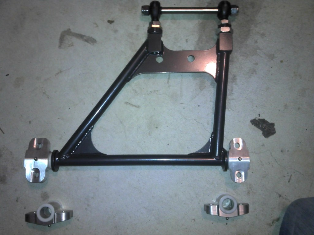

Recently I purchased a set of Techno Toy Tuning rear lower control arms and decided to have some bushes made.
As I have a Ron Tyler type diff mount I thought that the rear diff cross member was redundant.
The design of the bushes combines the clamp and bush for a neater fit, this also gives added strength and allows the rear roll centre to be raised a bit.
If you're interested I had Chris Woods make them.

... and decided to have some bushes made.
Sinisha,
Are you trying to reduce the distance between the CoG and Roll Axis (by raising the rear RC), or are you trying the bring it to a similar height compared to the front RC (assuming the front RC is higher than the rear RC)?
I habe always been worried that the two adjustable bolts on either side are not strong enough for big HP cars. Hence I have shyed away from this set up. But those bolts look pretty big Sinisha. It's probably a non issue anyway. Nice set up.

    Dazda, The change is small so I don't expect a significant difference in car handling, but the aim is to get the RC closer to CoG to reduce the roll moment.
                I have done the same to the front and that certainly improved the handling.
    Craig, I'm not sure which bolts you are referring to, do you mean the bolts that hold the clamps in place?
