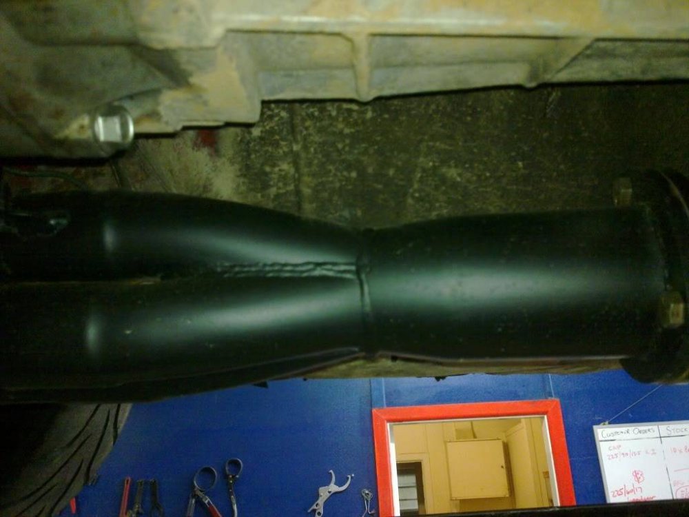

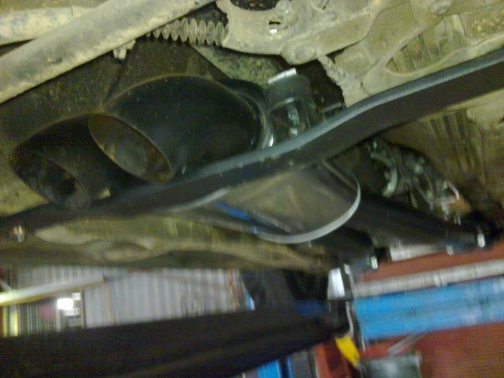

As you all know I have my LS1 in my 280zx and I illuded to some more upgrades, well got the car back after a massive cash injection (try $5k). New fat exhaust.16022011091.jpg

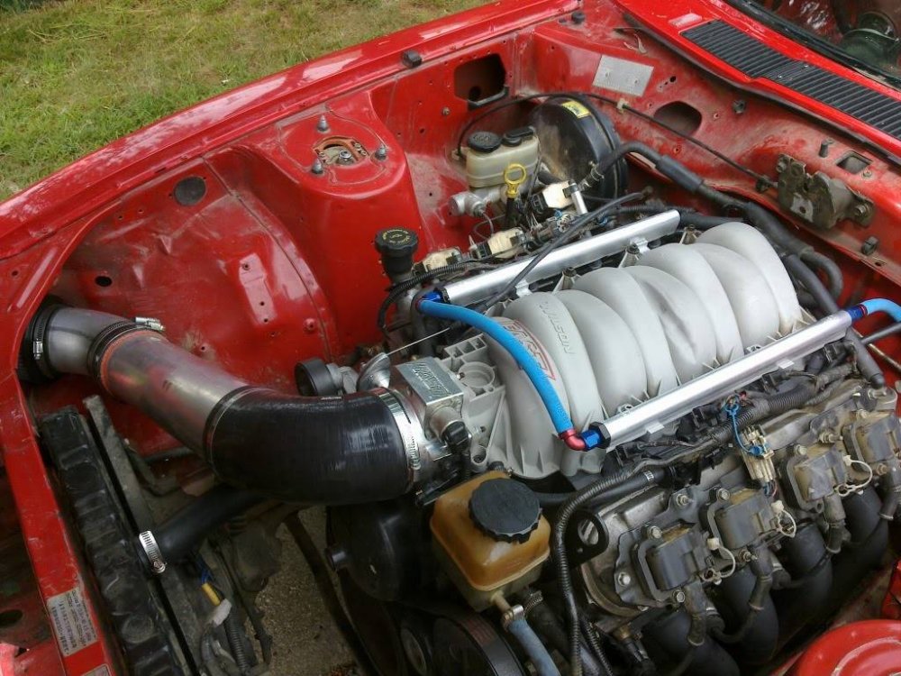

New bigger manifold and throttle body

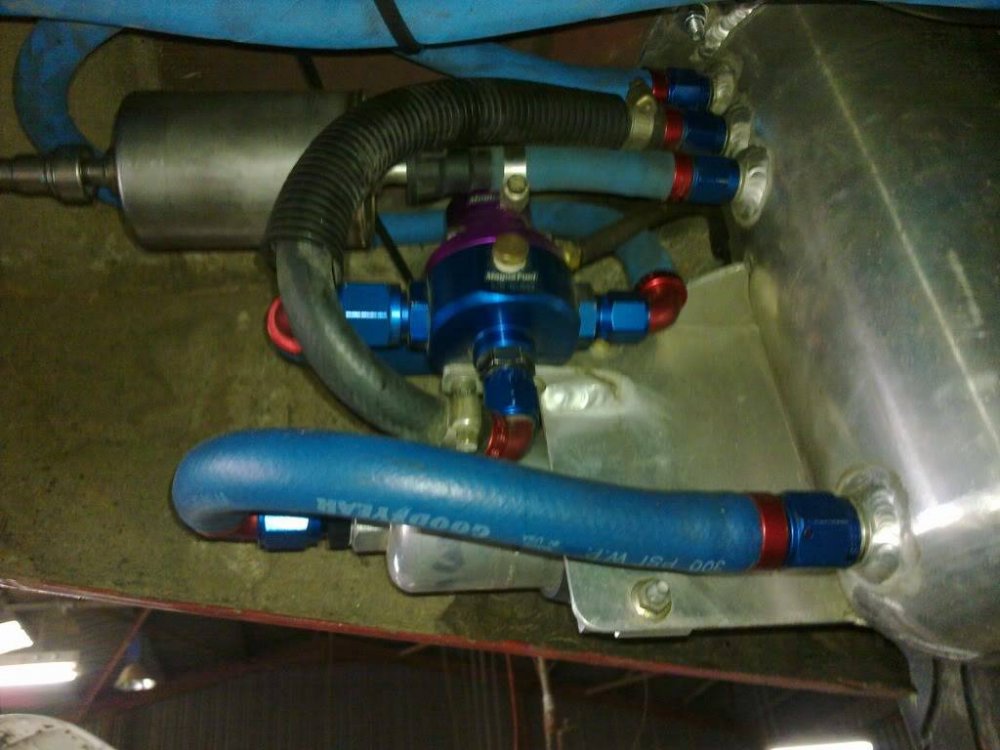

New re-routed fuel system

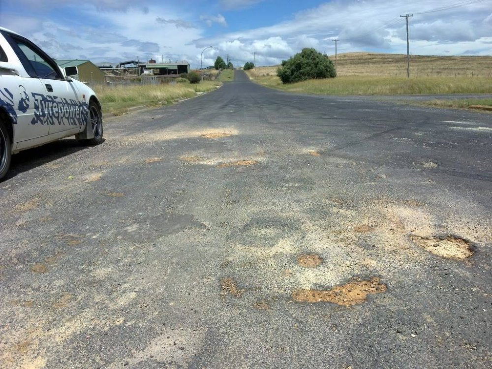

I had the car up the raod at a mates today and we found the lead issue, gave it a squirt on a pretty average road and felt fantastic.
Switched my race chrono over to 400m timer and recorded a 12.4 @ 191km/h. As you can see from the above, the road is horrible. If i was to bolt on some drag radials and be on the dragstrip I think I would easily pull a 11.5.

Nice work. We don't believe you about the lack of traction on that road, take a video next time ;D
Do you think there will be any issues running a dead end fuel rail set up like that. The factory one feeds the middle of both banks, kind of. Pressure might be getting low by the time it reaches the injector closest to the booster. I'm still tossing up how to do mine. Similar to yours but with a tee where the hose meets the passenger side rail which also feeds the rear of the drivers side.
I hear you concerns, and intially with the previous system I did run the reg after the fuel rail, this has been set up by my mate/mechanic who has many high hp Ls1's under his belt. because he ran a new 10mm line to the fuel rail all the way through he is confident that supply won't be an issue.
Was also done like this to reduce the amount of travel the fuel does, and hence keep down the temperature of the fuel.
last track day I did at Wakefield I couldn't even put my hands around the surge tank because of the heat. this system is what ASE sells for up to 400rwkw so should be ample.
