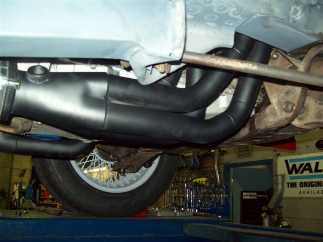

PeterAllen Posted October 26, 2010 Posted October 26, 2010 I know this was discussed not so long ago but I can't find the thread - apologies. We are having a fair bit of trouble keeping the primaries and collectors tucked up around the sump and bellhousing on the LS1 install. We still have good ground clearance but it just looks a bit unusual. The NSW regs state you must have 100mm ground clearance and we can achieve that easily. I'm just wondering if this is something I should be aiming for or is it too low for comfortable everyday driving? Quote

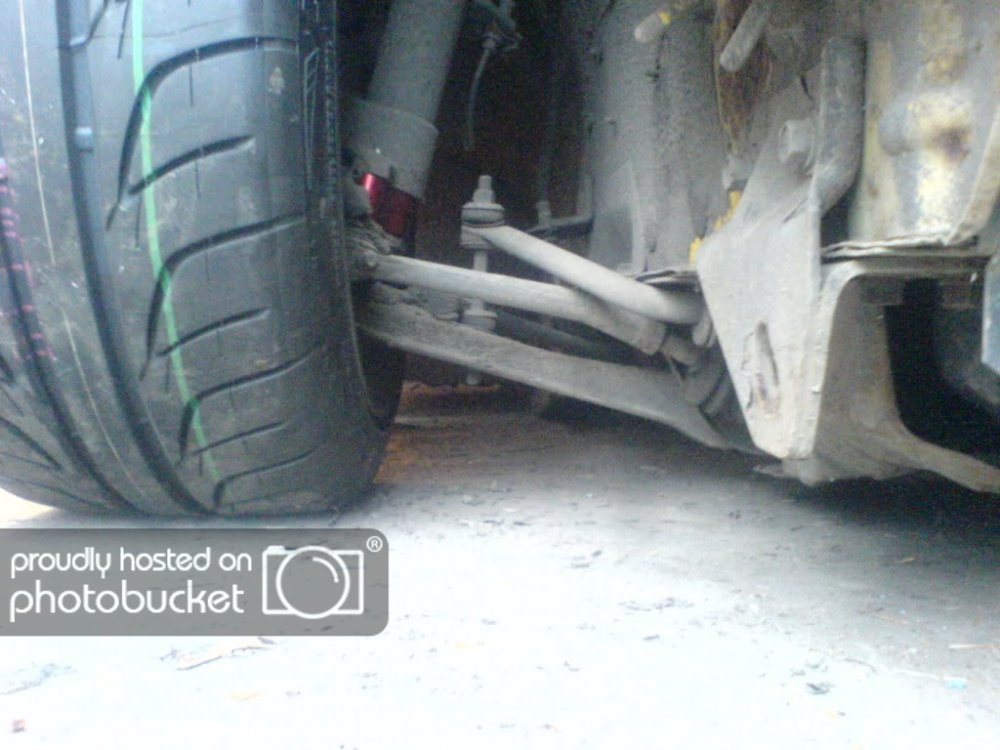

Whittie Posted October 26, 2010 Posted October 26, 2010 You may find 100mm uncomfortably HIGH for everyday use. With a big motor like that you'll want stiff suspension which usually means fairly low. I haven't measured it but I think I have around 5cm of ground clearence on my zed, and that is too low for every day. Makes speed bumps an issue. I'd suggest 7-8cm as a great look and feel inside the car, but I like it firm. As to how low is it possible to go: Chassis rails on the ground Quote
