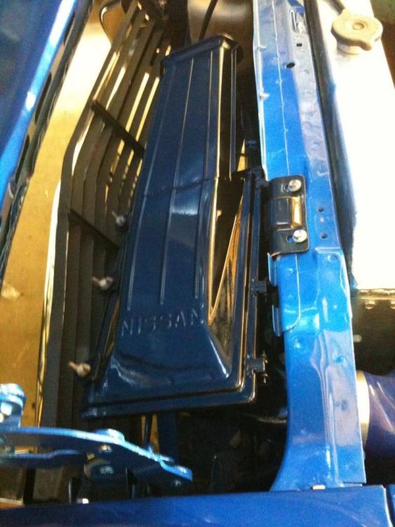

maddos Posted May 22, 2010 Posted May 22, 2010 Now that I've finished adding the 280z air filter box to my EFI 260z, have found the car feels like it can't breathe any more, noticed more at low revs. I thought maybe a better flowing filter like a K&N or lukey. Went to repco yesterday and the K&N was listed as $160 I was expecting to pay a premium but that just seemed a bit ludicrous. It's a common size filter which is used in heaps of models like the 300zx. Anyone know if this price is overinflated or could recommend another option? Quote

tbscobraZ Posted June 8, 2010 Posted June 8, 2010 I don't mean to burst ur buble but im pretty sure the oiled type foules the air flow meter. I read that the Z uses a vane type which can be damaged by oil getting into it and fouling the potentiometer. But i could be wrong. A solution thats often used is to box the filter in so it doesnt get wet. Quote
maddos Posted June 8, 2010 Author Posted June 8, 2010 It's this one here. http://cgi.ebay.com/ebaymotors/ws/eBayISAPI.dll?ViewItem&item=200461138065&viewitem=&sspagename=STRK%3AMEWNX%3AIT Will be fitted in this. I had the pod fitted previous and the oil didn't seem to cause any dramas, touch wood. Quote
