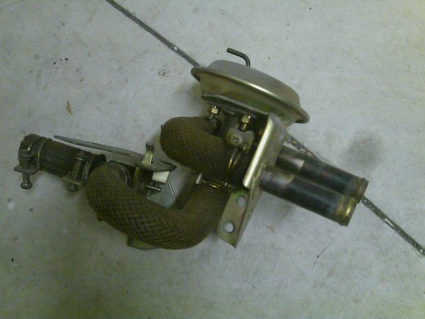

picture of spare heater tap for a 260z. Let me know if you are interested
Hey mate, looks like I need it - the one Baz got in was the wrong one.
Will shoot you a pm.
