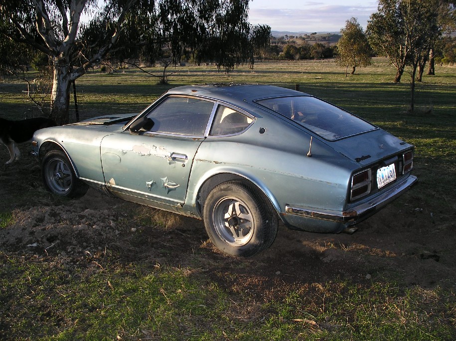

I rolled my 260 coupe into the shed for the start of a long rebuild. My aim is to have a daily driver, and seeing as I live on a 5km dirt road, I'm not looking for restoration perfection.
I encountered my first stumbling block within about 1/2 an hour. While tooling around with some dodgy patches of bog, I pried out several fist sized lumps that were concealing two 4 inch holes in the body - one behind the rear guard, one just in front.
I'm keen to get the car back up and running fairly cheaply, but I'm not happy about just rebogging and repainting.
I'd like to hear any suggestions you may have in the realms of plastic/fibreglass patches, metal inserts, metal bog etc etc.

If you are OK at MIG welding and handy with an angle grinder then you can get replacement rust repair panels for that dogleg piece behing the door.
If the other major hole is on the inside of the wheel arch behind that dogleg then you will have to cut it out and fabricate a replacement piece or get the inner wheel arch piece from a wreck
But if the holes are that big then when you cut off the outer section I am pretty sure the rust where you cannot see will be worse. Rust starts on the inside so by the time you see it then its a bigger problem.
You could try AllZparts in Sydney for the repair sections or if you want it done for you try Rob at ZWorx here in Melb.
Warren
Hi Jimbo, for me there is no other alternative than to get out the mig welder and replace rust with good old sheet metal. If your not good with a welder well I guess you can always learn, my opinion is you can't make it much worse than bog or rust and you can always fix your errors if you make a mistake.
