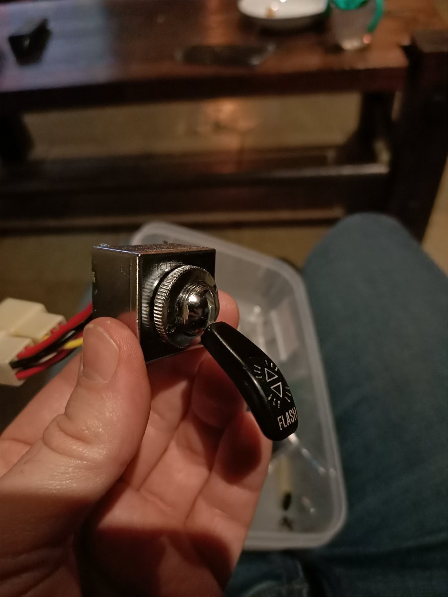

This is really easy, basically I have had this broken switch for a few years. I got it cheap because it was broken.

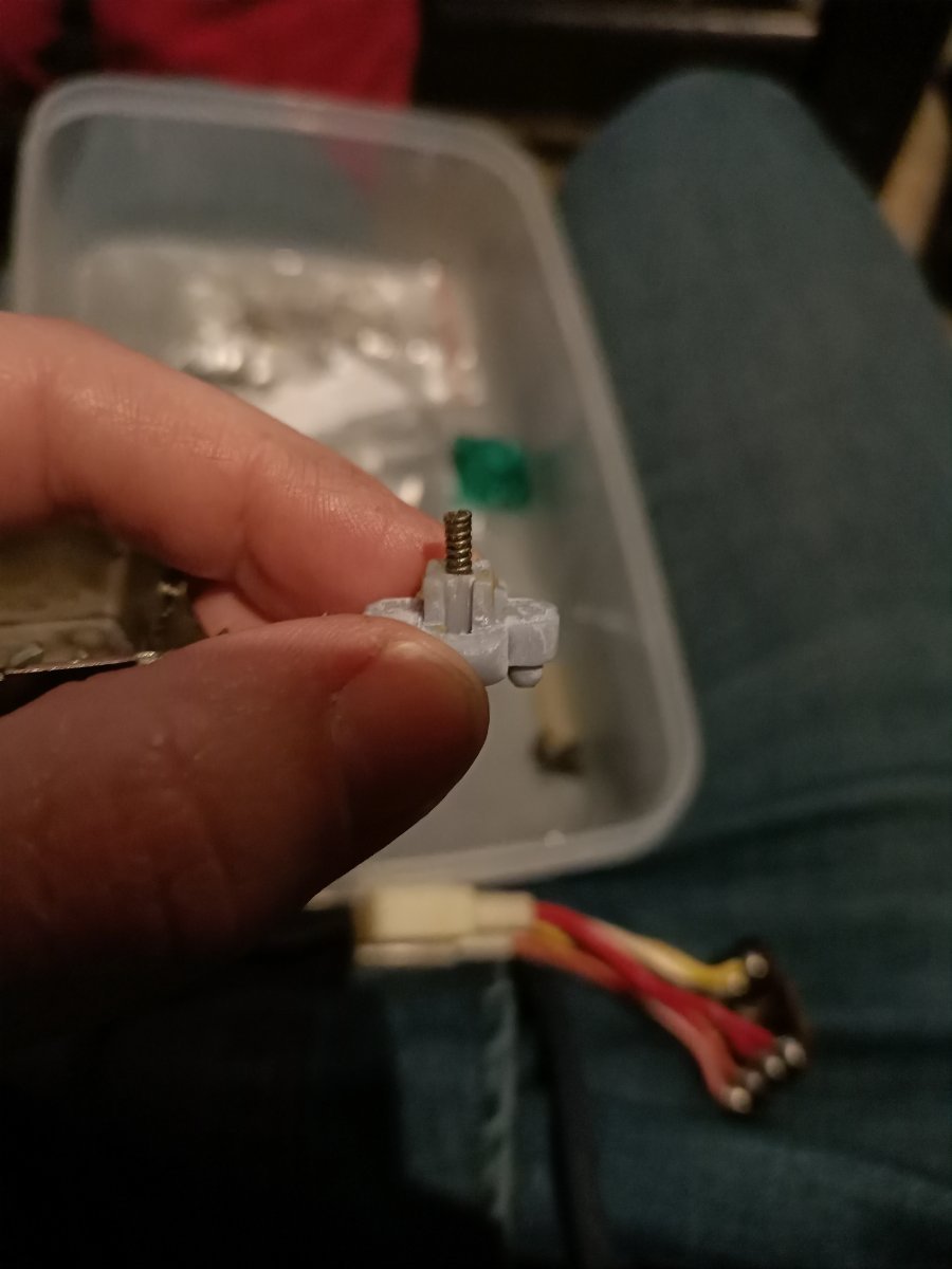

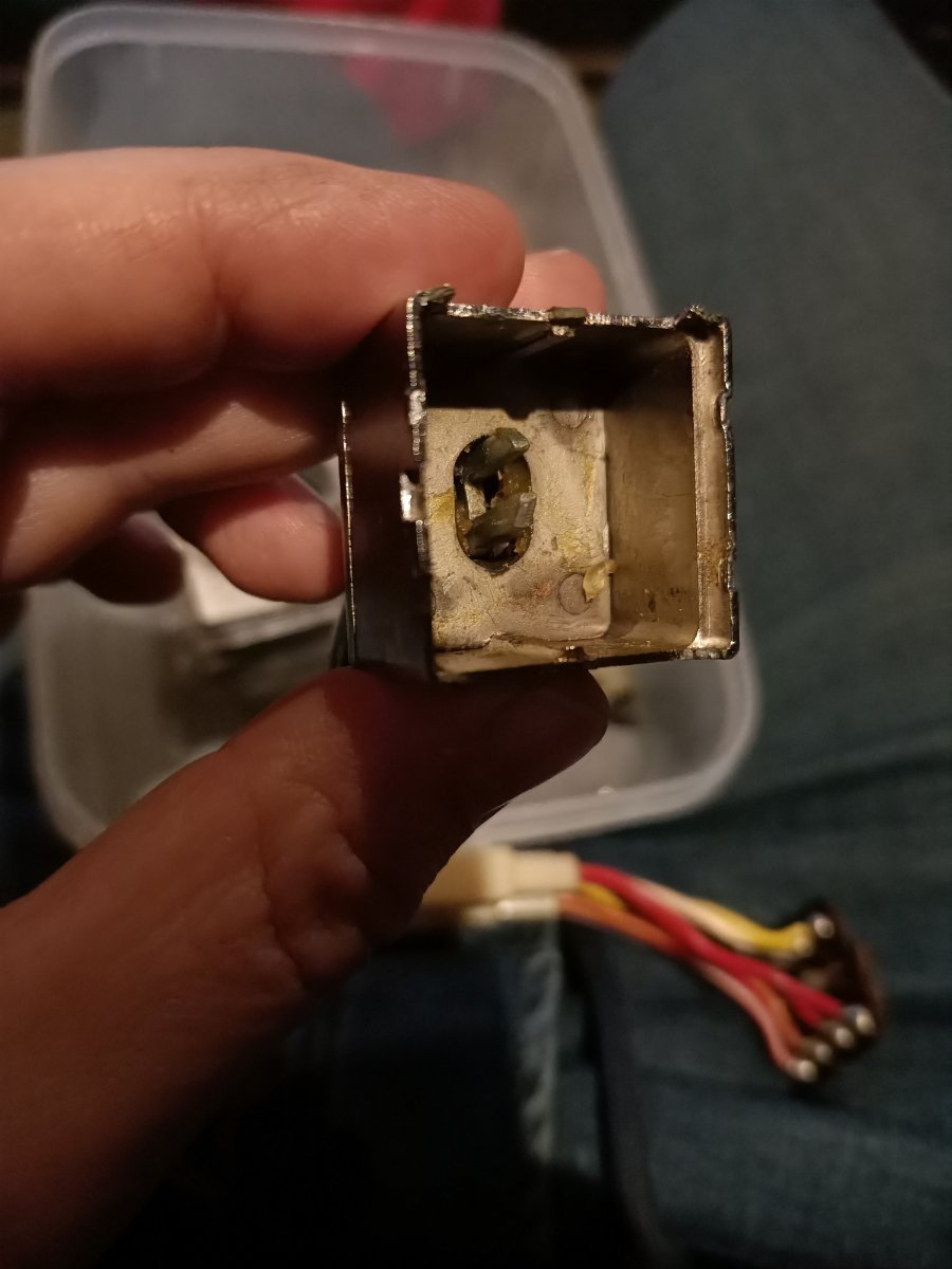

The little plastic bit inside breaks. Which the spring sits into and has the 2 little plastic nubs that rock on the switch itself to turn hazards on and off.

Basically place the spring in the back of it, apply the dialectic grease on the plastic nubs, slide it onto the metal part and then put the circuit bit back in place (it has tabs so you can only install it 1 way) and then use a set of pliers to crush the edges to hold it in place.
Voila working switch again for another 40-50 years. Let's hope!
