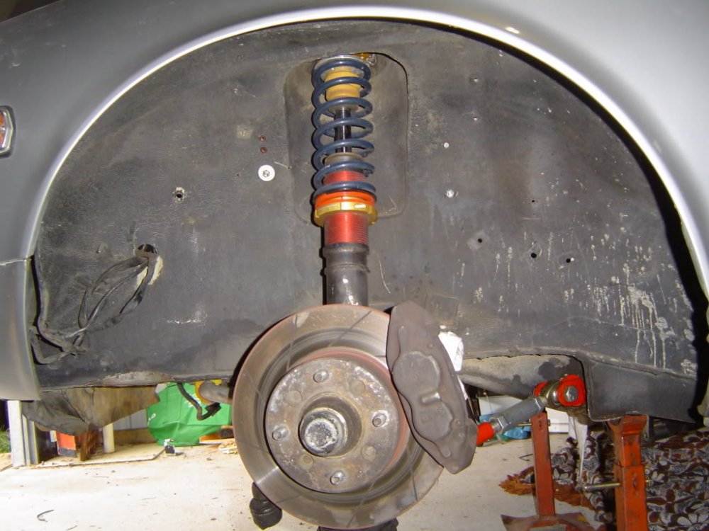

sco_aus Posted August 7, 2006 Posted August 7, 2006 Well after all this I have learnt a great lesson, don't rush and talk to your suspension guy first. All the equipment is available in oz to work except for the adjustable camber tops which I got from T3 in the states. Unfortunately these have to be welded in therefore you loose the top bolts that the strut brace would bolt to. Also, we weighed the car in all for corners at once to see what the best spring rates were for the car and are nothing like what I ordered from the states, so now I will be running dual stage Eibach springs. So here is what has ended up happening. Note the new strut brace. Quote

sco_aus Posted August 16, 2007 Posted August 16, 2007 Finally, after a stupid amount of time waiting for Bilstein to build me some shocks, I have finished my rear suspension (except for springs). I had to get Bilstein to make me some because the struts were wider and Koni had them listed as being the same, dont know what the go is there. A couple of pics, ill get some closer shots later. Note, rear disk calliper brackets This was a very expnsive venture all up, especially having to get the 240Z rear struts cut up for height adjustment and then the 260Z rear ones. Quote
