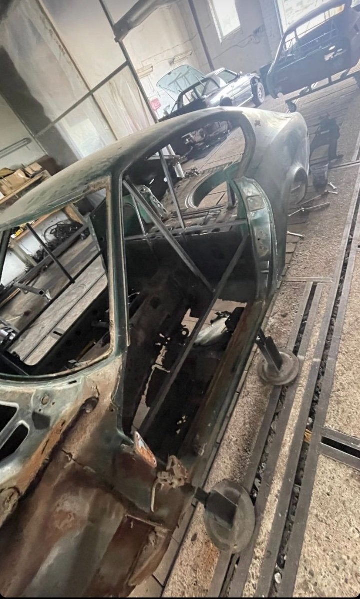

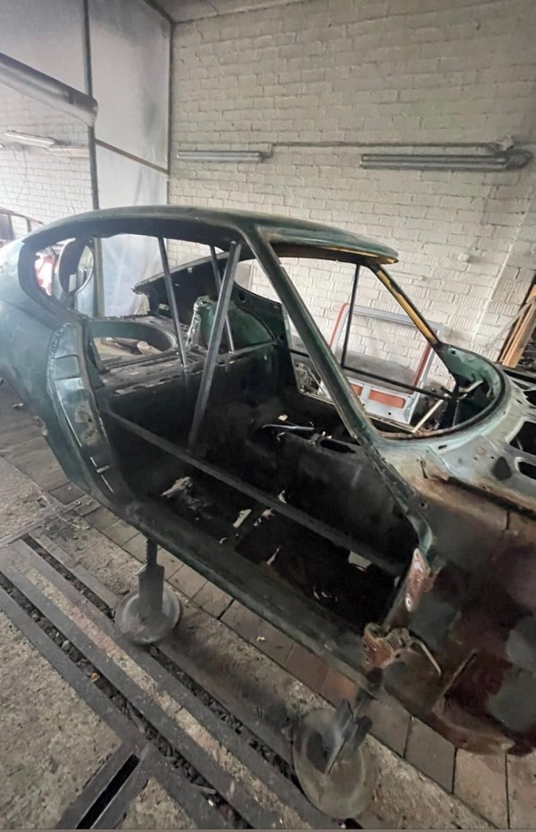

I came across these photos on Instagram of some chassis bracing that has been installed on a very rusted out car in Europe, the outfit is dcw classics and they look like they do good work.
817DBD64-13FA-40B0-A160-D701C3303EB0.thumb.jpeg.64f3e5715779ae8d74d9e0637dcea4ef.jpegCA3770F0-B7E4-45D3-B1D1-7FECECBDCD70.thumb.jpeg.a6bb37e3a15f5bba5256a26484dd8801.jpeg
I have been pondering how I was going to brace my car before it goes on the rotisserie for a while and hadn’t settled on anything. My car is not as rusty as this but is still compromised.
IMO I think this is an excellent method that others in the future may find useful so wanted to share.
Has anyone used a different method for bracing their car?
