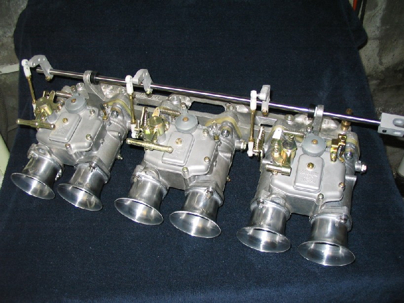

luvemfast Posted August 7, 2008 Share Posted August 7, 2008 Looking to buy these from the USA. Is there any problems you could see that I will have with these. What should postage be? I've had quotes from different sellers ranging from $135 to $330. Thanks, Simon Quote Link to comment Share on other sites More sharing options...

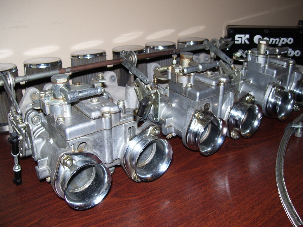

luvemfast Posted August 7, 2008 Author Share Posted August 7, 2008 Thanks. Can you see any problems with the carbies themselves? Are they the same, anything visually wrong with them? Alan, when I was talking to you Wednesday night at the NDSOC meeting. You made me a bit wary of buying second hand from the US. But Wolf Creek is not really in my budget ATM. Quote Link to comment Share on other sites More sharing options...
260Coupe Posted August 8, 2008 Share Posted August 8, 2008 Simon yes I understand the budget issues however I have learnt numerous times over that the "cheap n cheerful" option can turn into a financial black hole trying to get things right......hence I now spare no expense (well almost no expense) when it comes to doing thing right the first time. Many a set of triple carbs picked up for <$1000 turns into $2000+ by the time the worn parts are replaced or remanufactured, the linkages are sorted, modified, etc and add dyno time for tuning. The path I am taking is to purchase a set that are "as new" (completely refurbished) whilst more $$ up front........I believe cheaper in the long term and far less angst as they will bolt on and run with very little tuning required. The carbs you have found look fine externally however it is the throttle shafts and linkages that wear and the butterflies that wear away the castings internally.......soft parts such as gaskets and diapragms also go hard or leak.....all this cannot be found until they are dismantled..........again it is the risk you take and you must consider this in the purchase price . cheers Alan Quote Link to comment Share on other sites More sharing options...
