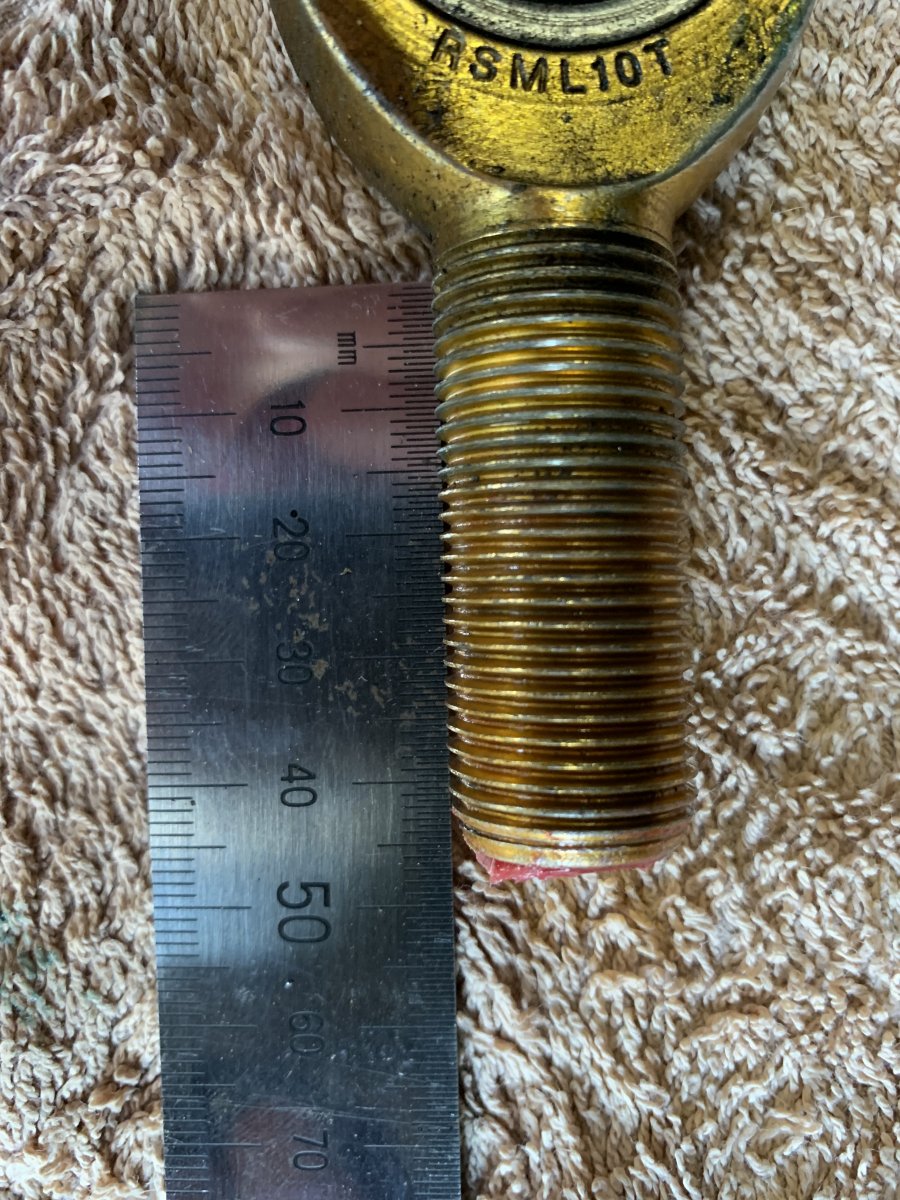

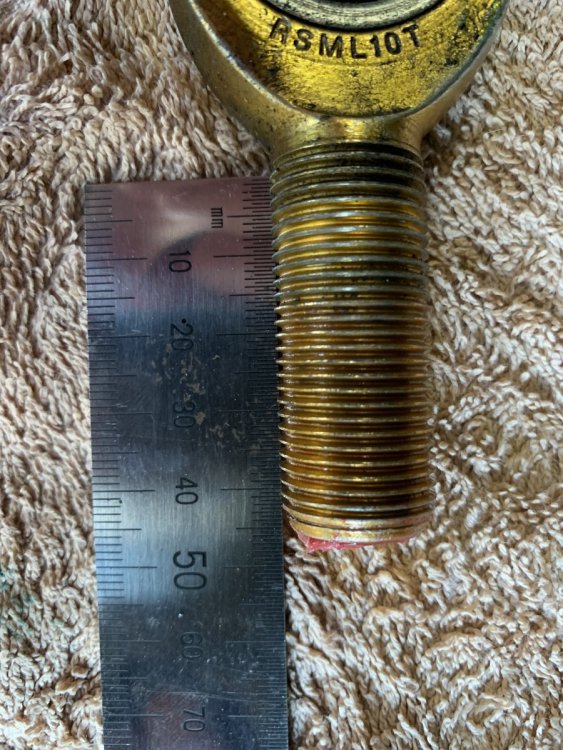

PeterAllen Posted June 22, 2019 Posted June 22, 2019 Mine are on the car but measurable. I also have a jig. I see you are in Australia, that's handy because so am I. https://postimg.cc/CRrkjC2s Quote
Roady Posted June 22, 2019 Author Posted June 22, 2019 Hi Peter, Thanks I had a quick look at your photo, I was wondering if you know how long the threaded sections are, i.e. how long the threaded section on the rose joint is and how long the threaded section is on the adjusting nut/sleeve. Cheers Jason Quote
PeterAllen Posted June 23, 2019 Posted June 23, 2019 You could get the rose joint thread length off a manufacturer's data sheets I can't measure the length of the thread on the adjusting sleeve but if you assume the locking nut is 10mm then you would be safe making the thread 45mm. https://postimg.cc/N5pqVPq1 Quote
Roady Posted June 23, 2019 Author Posted June 23, 2019 Ok great thanks for the other photo Peter I appreciate it. I think the rose joint thread length to be 45mm from a data sheet I found online, which would match the info from your photo and what you’ve suggested regarding the adjusting sleeve. Thanks again for the effort mate. Cheers Jas Quote
Roady Posted June 26, 2019 Author Posted June 26, 2019 As Peter said, 45mm for shank and sleeve is approx. 60mm internal thread length. Quote
