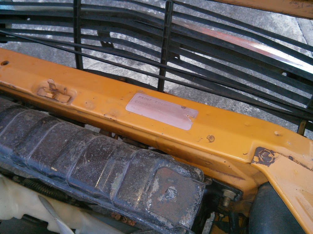

Does anyone have photos of where the body colour decal and the air filter decals go please?
Just putting the finishing touches in place before the car is delivered.
The body colour decal or sticker goes on the radiator support panel. Be sure to put it on slightly crooked, like your a factory line worker in a rush ;).
As far as I'm aware our market didn't get the stickers on the air filter housing, it seems it was a North American market thing introduced when they got the 'flapper' air box. This was due to colder North American climates and I believe the decals/stickers had instructions on making adjustments to the carbs and air filter flapper for different weather settings.
