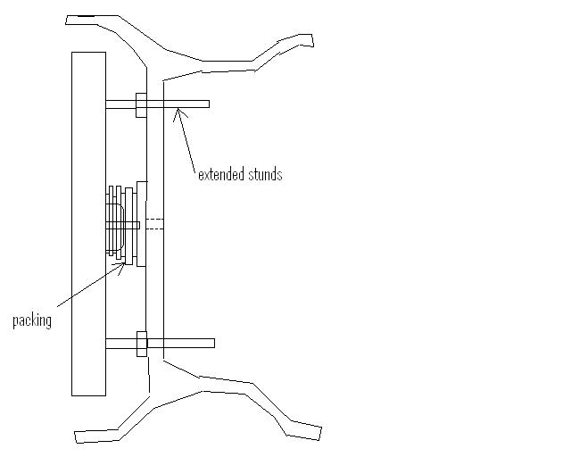

Toecutter Posted March 30, 2006 Posted March 30, 2006 Hi Ben, I had plenty of room with the 17x7 and the 15x7. From memory the adapters were 45mm thick both front and back. I suggest you go for a tad less, like 40mm. The best way to do it without any trial and error is to mount your wheels and see how they sit. Get some long bolts with the same thread as your studs and cut them so that your left with just thread. Then extend 2 of your studs by using the nut as a bush to extend your studs with the length of cut bolt. You can now put your wheel on using these extended "studs" to guide and secure the wheel. I used the other two studs to "pack" on peices of 5mm thick steel plate to hold the weight when the car was released from jack and also as a guide for adapter thickness I would need. I found this was a good system because I played around with many diff thickness adapter until clearance was good all round and I could let the car sit for a good idea of it's stance. I might have lost you but a rough sketch below. Just be careful when you lower the car in regards to weight distribution. I kept the studs in a horizontal plane with the weight resting on the plates which as you can see had holes drilled in them so they could sit over the other two studs and not fall off. You can add and remove flat plates until you get the car sitting right with no tyre rub and filling out the guards to get the "look" right and once decided just measure the amount of packing you have to get the adapter thickness. Also good because you can check on steering and tyre rub on the front valance. Quote
Zeddophile Posted March 31, 2006 Author Posted March 31, 2006 hmmm ..... your wheels must have sat pretty damn close to the front strut yeah? with my math, your rim sat 10mm closer than stock, even with the adaptors - I don't know if theres even 10mm clearance to my strut (there certainly isn't with the tyre there, but i think it'll be rim sitting there with 16s... I wonder if yours has smaller struts..... Quote
Toecutter Posted March 31, 2006 Posted March 31, 2006 I had plenty of room on both front and rear strutts. would'nt be surprised if the early 260 had smaller strutts. But then again I ordered standard lowered springs from King springs so the coil diameter is probably the same as yours. If you mount the rims with 10mm space tyre to strutt, how much room will that give you on the guard/tyre dist? Quote
