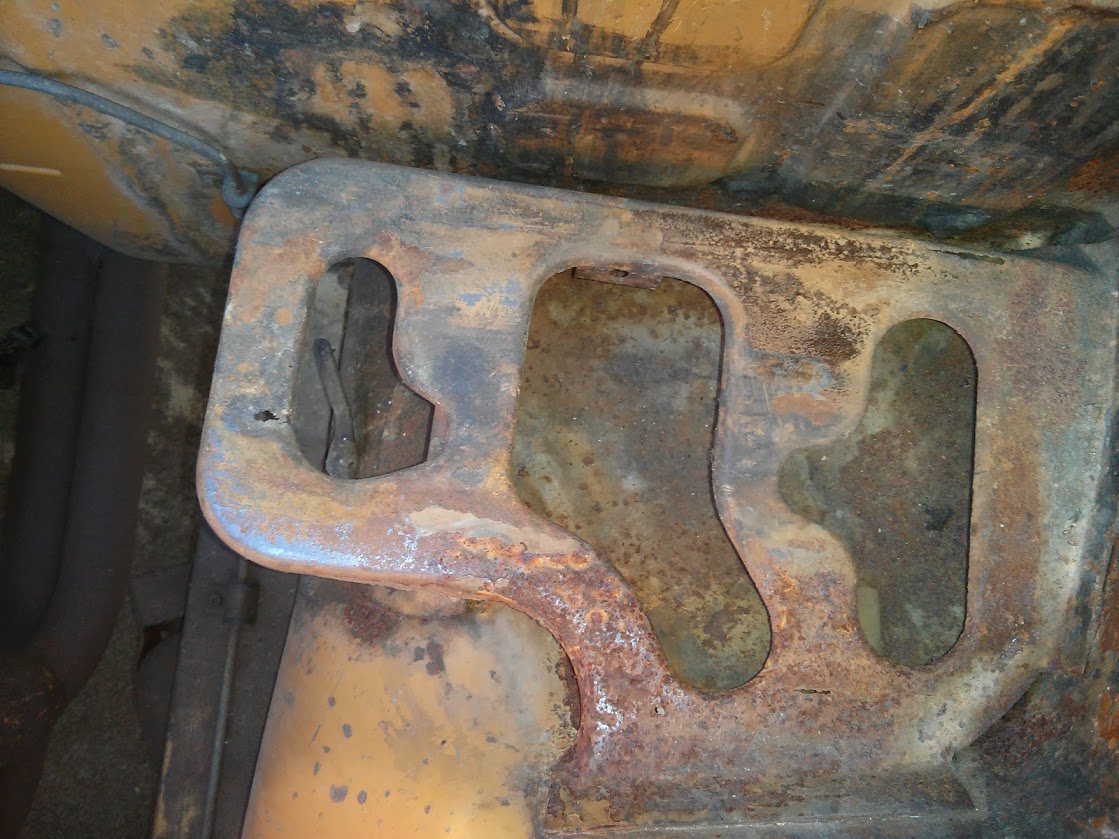

Could you send me a picture of the area, also is it for the 1974 260z 2+2
Battery tray areas are the same throughout all years, between 240z / 260z.
The tray itself is spot welded in place, but it's usually underneath where they rot out due to battery acid eating away at the steel. There is meant to be a plastic tray underneath the battery but most have been removed over the years.
Attached photo from my car HS30 00150 - which did have the plastic tray and was spared a rusty death..
