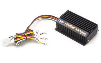

I currently run a Pertronix module / setup in my L28 (SU Carbs). I've just got my hands (very cheaply) on a Crane  XR3000 ignition module and a matching LX91 coil. My question is can this be used in conjunction with my pertronix? Does anyone run something similar?

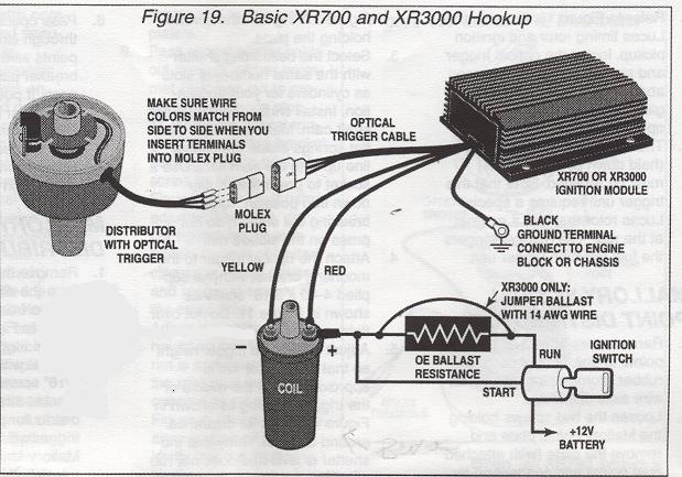

It seems Crane have their own module which is an optical pickup / trigger and has three wires that come out of the dizzy whereas the Pertronix is magnetic (?) and has only two wires coming out. As per the diagram attached the Crane XR3000 ignition module has three wires that seem to match their own module only. After ringing up Crane they said it doesn't work with anything else but a crane module but I just wanted to make sure before I buy their module and ditch the Pertronix.

What is the Crane going to do that the pertronix won't? The XR isn't a CDI box.
