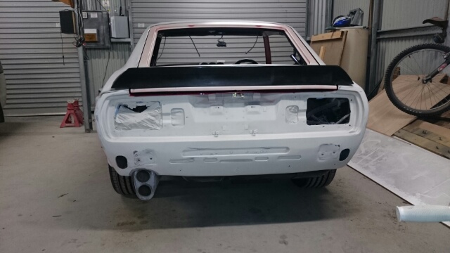

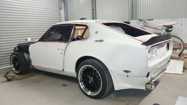

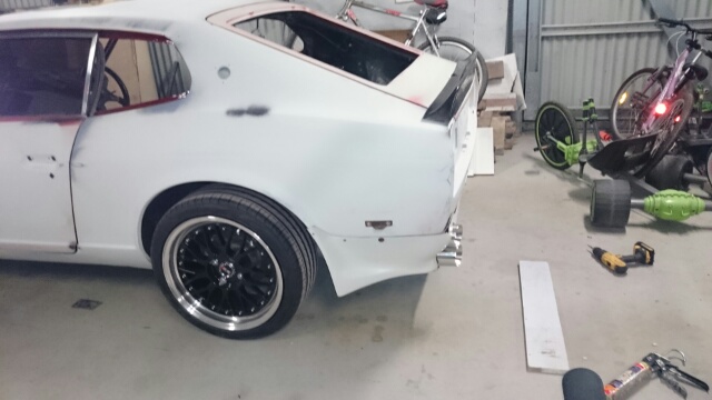

red76z Posted June 29, 2015 Author Posted June 29, 2015 All fitted up today. It is a little narrow for the 2+2 but I think it works quite well. Quote

red76z Posted June 30, 2015 Author Posted June 30, 2015 http://m.ebay.com.au/itm/DATSUN-240Z-260Z-REAR-BOBTAIL-SPOILER-/231315801779 This is from the 240z. They are about 1-1/2" to narrow for the 2+2 but there is nothing in the bobtail form to suit the 2+2 yet. Fitment is quite easy but the outer bolt tabs are right on the edge of the hatch. So I am using 4 of the 6 fixing point's. Maby bit of sicka on the edges for final assembly. All in all a good option. Quote
