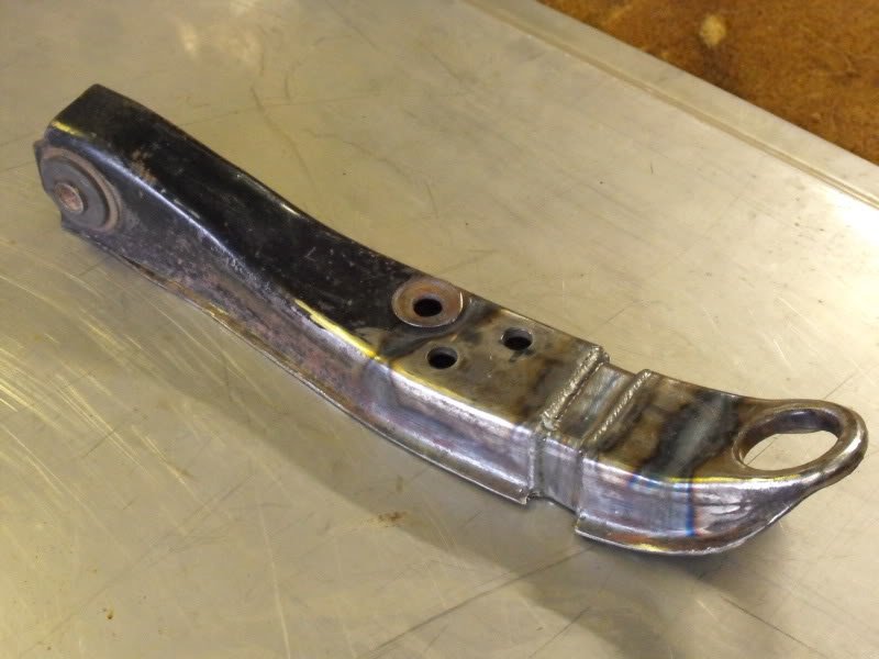

Jwalker590 Posted April 22, 2015 Posted April 22, 2015 so im pretty set on doing the conversion... only problem i can see is that the s13 lca is way too short which give the car positive camber even with top hat adjustments set all the way negative. i also read somewhere that adjustable s13 lca's dont extend long enough... apparently needs to be extended 2" to correct camber issues. is extending an lca's safe? I've seen people in the states drilling out the top bolt hole of the coil overs to correct the camber but that to me sounds and looks really dangerous? can you slot a longer rose joint into the adjustable arms? any other way to correct camber besides extended arms? cheers Quote

bryan3976 Posted April 28, 2015 Posted April 28, 2015 just extend the lca alot of drifters do it . bolt it all up look at how much you need to extend it by and weld away. Quote

Jwalker590 Posted April 28, 2015 Author Posted April 28, 2015 haha no worries mate, I'm not extending it myself. was just wondering if anyone had found an off the shelf aftermarket arm that extends long enough. not looking for a diy guide on extending arms haha Quote
luvemfast Posted April 28, 2015 Posted April 28, 2015 Don't think you'll find an off the shelf fix for this. Quote
