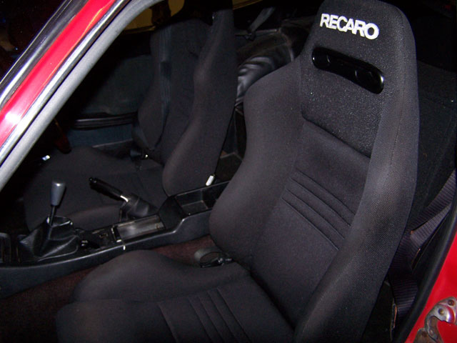

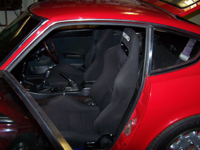

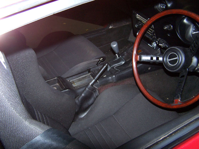

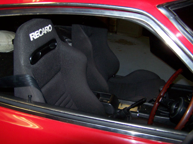

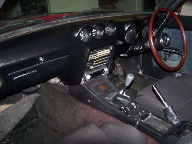

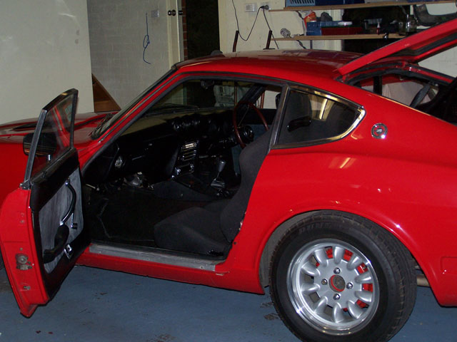

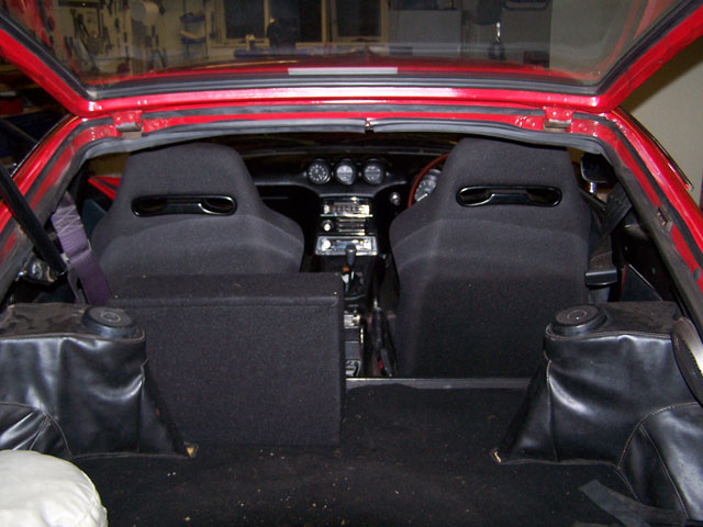

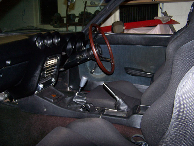

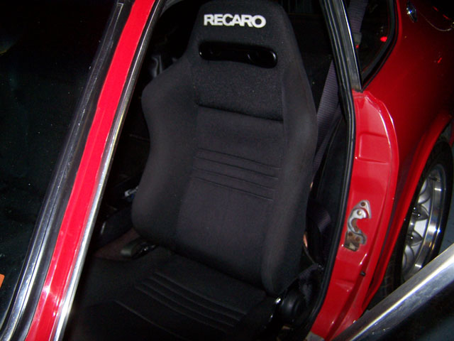

Administrators gav240z Posted November 22, 2005 Author Administrators Posted November 22, 2005 I got my seats in take a look at the pics Quote
