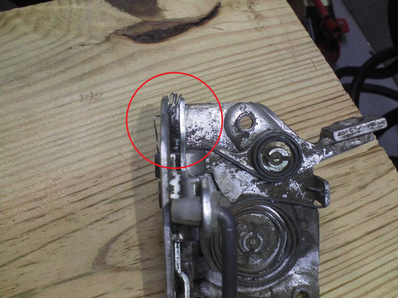

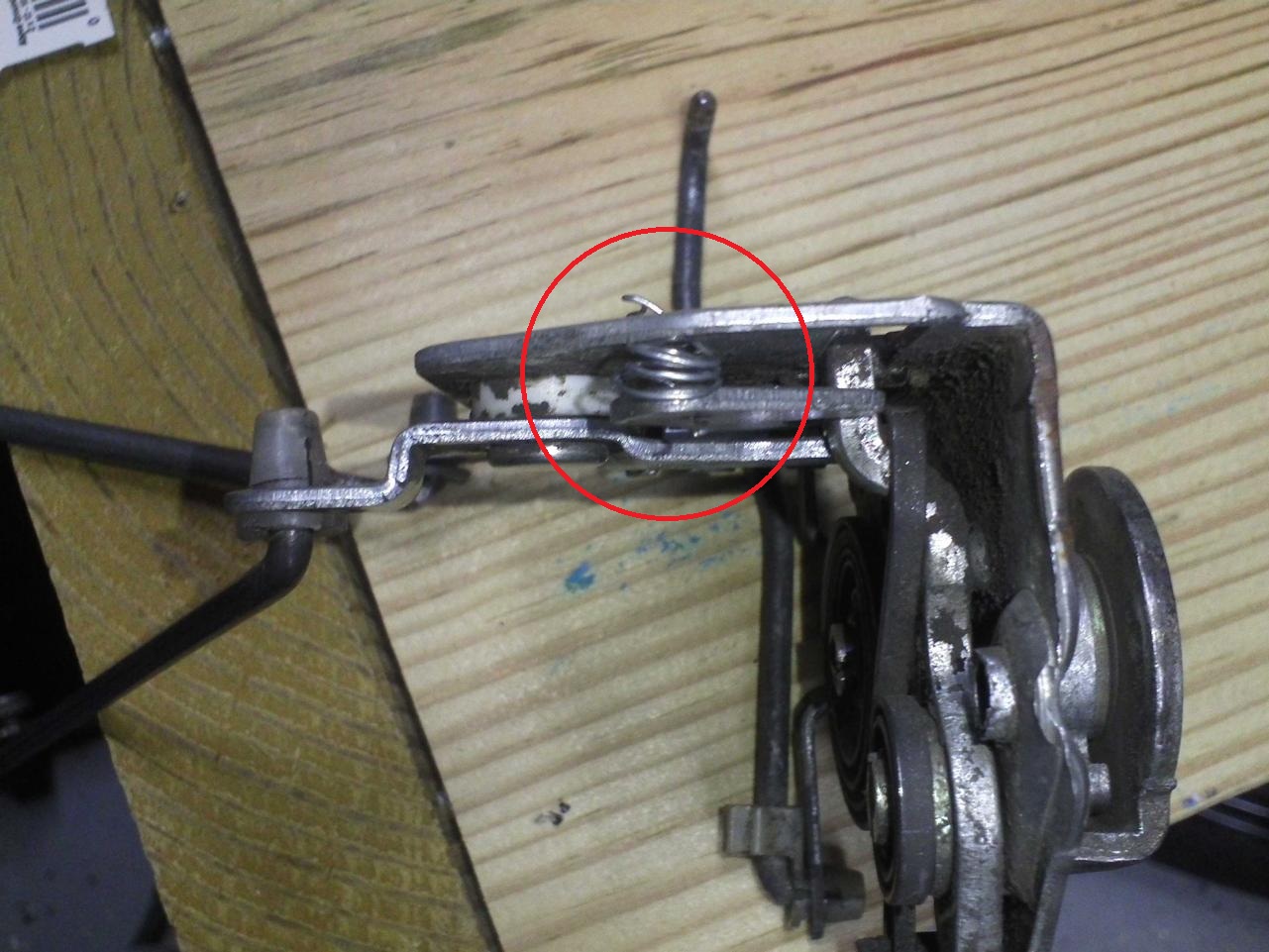

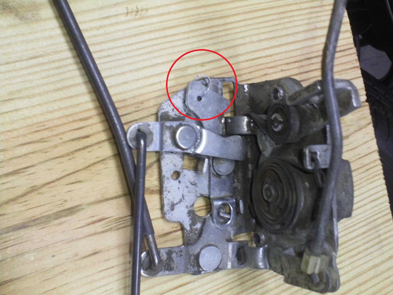

theremm Posted August 22, 2014 Author Posted August 22, 2014 Mmmm - i'll keep that in mind for the passenger side door as it is experiencing the same problem you described. Thanks for the tip. I had a chance to look at my driver's side door mechanism again, and also after comparing to the passenger side door it is apparent that I am missing the spring which is highlighted in the attached photographs. This would explain why the mechanism functions correctly, however does not remain unlocked when I remove the key (i.e. the mechanism 'falls' back to the locked position). It doesn't appear that you have this spring in the mechanism you posted Quote
Moderators Zedman240® Posted August 23, 2014 Moderators Posted August 23, 2014 That spring is in there; it's just sandwiched between the two metal parts. That provides the locking click. Only issue mine had was the screw length thing...found that out after I pulled my door apart! Quote
