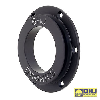

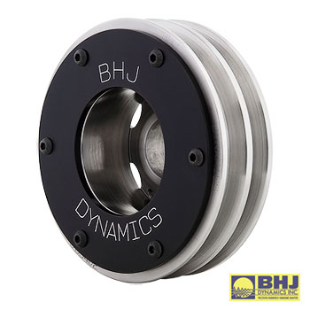

  The posted picture is the BHJ Street Performance Special Two Pulley L series Datsun Harmonic Balancer. It states on the page that it was Developed in co-ordination with Rebello Racing. I should have mentioned that I was talking about the street one, not racing one. You were right on the money about the price. $470.00 plus a couple hundred postage,then the conversion. Thanks for the advise about the full length keyway and longer bolt. I think I saw a Kameari bolt on the Otomoto website that was guaranteed not to come loose.

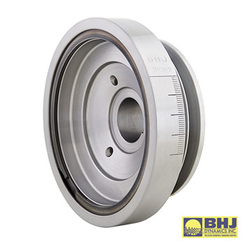

            Just a bit more info on BHJ harmonic Dampers. It was recommended from Chris at BHJ Dynamics that a better damper for my application would be the one listed below instead of my first choice.. As you will see the prices are in New Zealand Dollars as Barry Manon at Manon Racing Products is the local distributor. Exchange rate with New Zealand is better and freight is only $35.00nzd.
They are both the same price for alloy or steel.
Damper...NIS-IB240-280Z-6 (steel), NIS-IB240-280Z-6-C (aluminium):  $450nzd
Power steering pulley....NIS-240-280-PSP:  $170nzd
Installation kit....HD-1:  $135nzd
Kit metric conversion....HD-1-AM16-1.5:  $20nzd
This damper has the option of adding the extra power steering pulley to the front if running in a 280zx. I have ordered one just in case. The installation kit and the metric thread conversion is always handy for the tool box.
