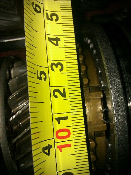

I got all my syncro and bearings through stewart Wilkins, he was very helpful with working out what specific kit I needed. I had an RB20det box which had double syncro on 2nd & 3rd. These are an inner and outer brass syncro with the steel cone floating in between the two. you can't see the inner syncro until you have separated the gear set. He got me to measure the gap to confirm the syncro type required.  see pic
