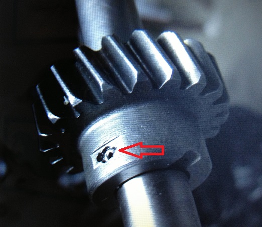

I recently read some info on people pinning the dizzy shaft. Apparently this is done on higher Hp engines as extra insurance to stop the gear from slipping on the shaft and resulting in timing or oil pump issues. It's only a press fit from the factory. My question is has anyone done this and are all the shafts the same length regardless of L20a L24 L26 L28?
I had a practice on a spare shaft, drilled a 3mm hole, fitted a high tensile 3mm solid pin and staked the end of the hole on both sides. Would this be sufficient?

Sorry, wasn't sure on the correct terms, maybe I should have said quill. I have found a pic of the mod someone else has done, I did it the same way as this but pressed in a solid 3mm pin.
Do you know if all the 'quills' are the same length? Could I use an L20A quill in an L28 or will it be fractionally shorter?
