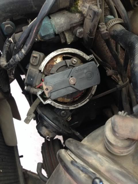

Pulled the original dizzy out and fitted spare
Look at pic
Its 180 out whack.
The original dizzy was rebuild by a moron and had it 180 out.
Should have known when i noticed even just cyl 1 going to 6 that it was 180 out of whack.
Just took me freaking ages to realise it.
Anyway engine started first hit with the key with replaced dizzy.
Bottom shaft and rotor arm was out. So pulled it appart reset it all and refitted to car and worked perfectly

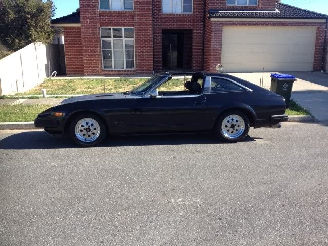

Anyway took the targas off and went for a drive. Drives well now still to check the timing but where i placed it seems to go lot better than before.
Looks ok from a distance must say.
Don't you love that when it happens... top pic is right; rotor should point to radiator. Good to hear it's all go...
