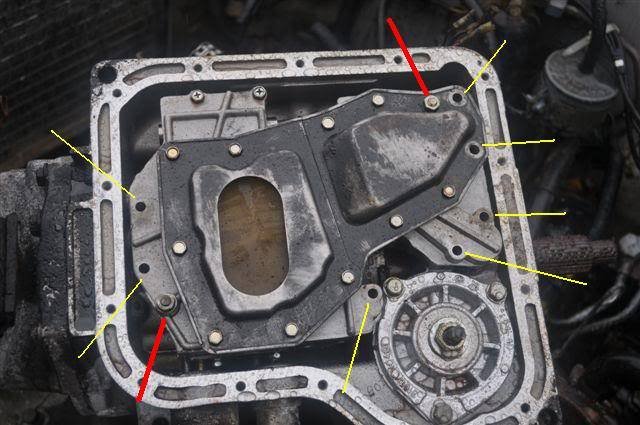

Ok. So to perform this conversion or swapping of valve bodies you do the following.
- Pick up a service kit from Repco or somewhere which includes a new bottle of trans fluid, a new filter and pan gasket. I also recommend running an external oil cooler if you live where it gets hot.
- Jack the car up, handbrake on and shifter in neutral.
- Undo the many bolts around the pan (sump for auto). Take note of how they aren't very tight. This is how they should go back on.
- Have a container ready to catch the fluid. Unfortunently there is no drain plug for this so it gets messy.

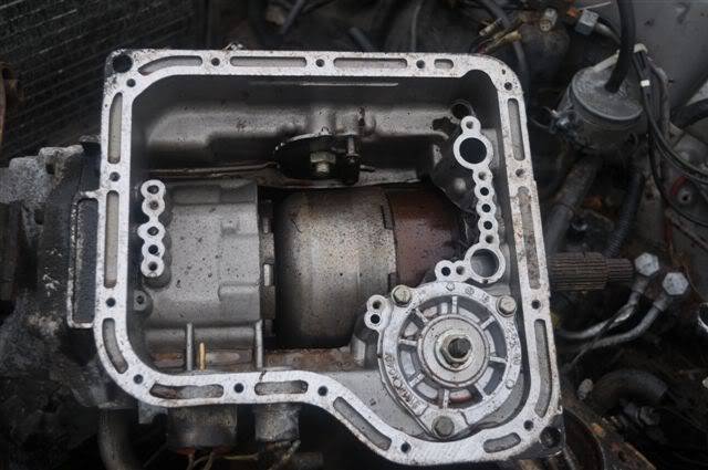

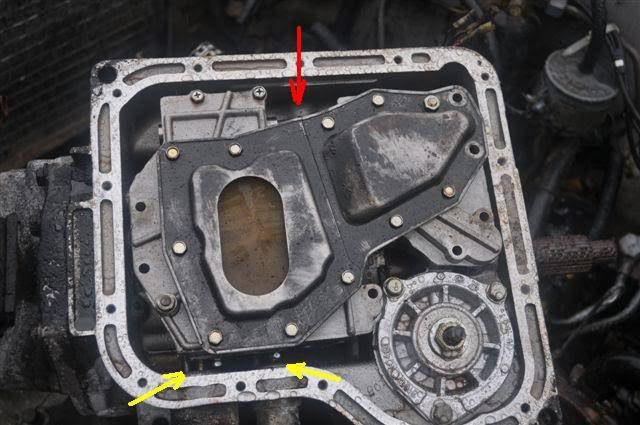

- Once the pan is off you should see this.
Posted Image
-Take note of the two pins from servos/solenoids on the passenger side of the trans (yellow arrows). They stick into the valve body and one may fall out as you remove it. Also, take note of where the shifter linkage sits in the selector rod. (red arrow) These pins and rods must go back the same way.
Posted Image

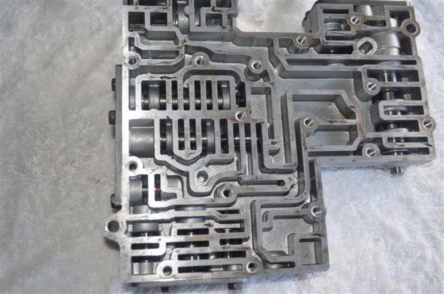

- Undo the following 10mm bolts highlighted with the yellow lines (read on first). Do not undo the ones in red as this holds the two halves of the valve body together. These bolts are different lengths so make sure you record or remember where they came from.
Posted Image
- As you undo the last few bolts the valve body should just fall out (don't drop it). Here is where you find out you haven't put it in neutral. (don't put it in neutral with no bolts holding it inside your trans).
Posted Image
Posted Image
- Remove the old filter by undoing the smaller 8mm bolts, as well as the one 10mm bolt with the nut. Ensure this goes back on the new valve body same way.
- The you get the modified valve body and install it the same way you removed the other one. Ensure the pins slide in to their holes as you insert the valve body and the shifter linkage sits in neutral.
- New gasket. trans fluid and you're away.
Clear as mud???

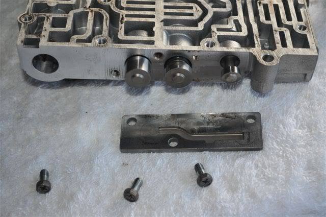

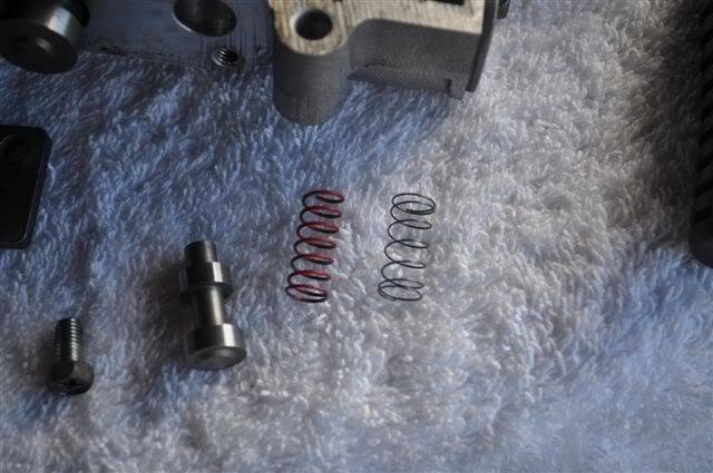

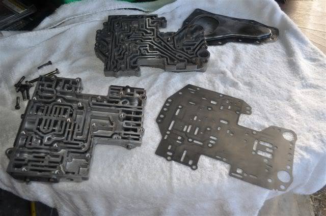

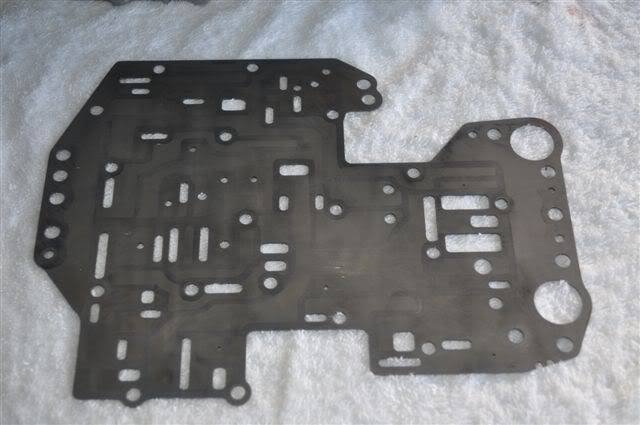

Well a spring is replaced inside the valve body to increase the fluid pressure obviously. And between the two halves of the valve body there is a seperator plate. Enlarging certain holes in this plate is the key to all of lifes mysteries. DIY?? Well it can be done from home if you are sent the stronger spring to replace and a template to enlarge the holes yourself, although pulling apart and putting back together the valve body isn't for the faint hearted. I was only thinking $100 exchange for the shift kitted valve body. I send you one and when your done, you send me yours to modifiy for the next person. Or, if you want a DIY option I could look into that. Any shift kits sold would see a donation to the site of course.
Any other questions?

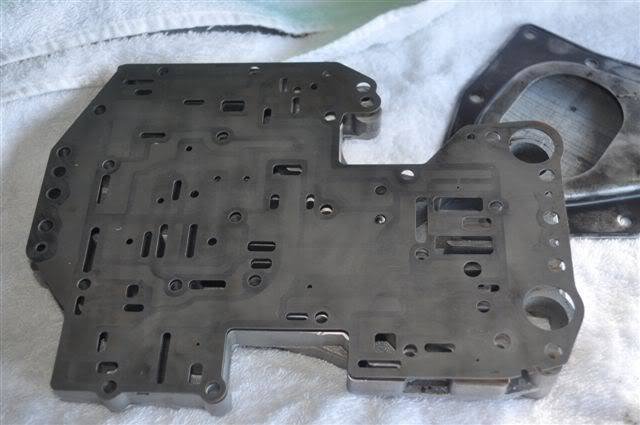

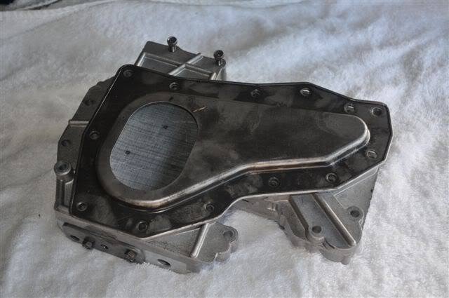

#16 Scoota G
Scoota G
  • 4,213 posts
  • Location:Ballarat
  • Tagline:Mark

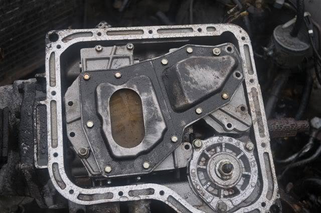

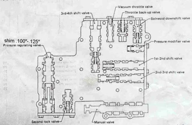

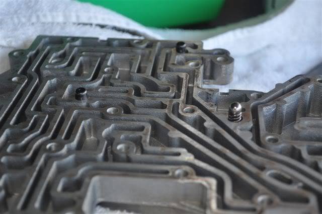

Posted 30 April 2010 - 03:16 PM

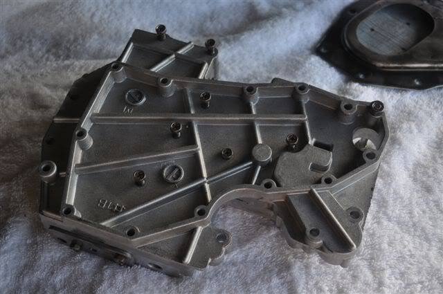

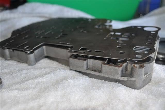

Hey Scootag, which model Z is your valve body from. If I could see a picture of a 260Z one I would be able to tell if they are theysame as a 240Z or 280ZX.
It's a 260C box i have in the garage... says 3N71b on the housing... Can take a pic of the valve body if you like.
#17 Scoota G
Scoota G
  • 4,213 posts
  • Location:Ballarat
  • Tagline:Mark
Posted 30 April 2010 - 03:33 PM
Oops, already done!!
#18 RB30X
RB30X
  • 1,981 posts
  • Location:Gladstone QLD
Posted 30 April 2010 - 04:05 PM

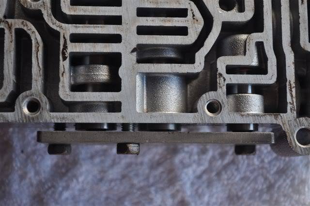

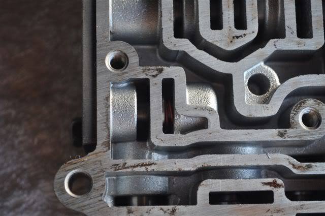

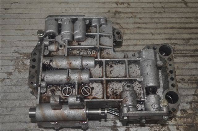

Thanks for that mate. That is a very clean transmission. They (260C and 260Z) are the same as 240Z's and here is where I'm confused.
You see in your second photo, there are four lumps along the top section of the valve body for the four valves. At the end of the valve body on the center or longest valve there is no hole in the side of the plate, so it does nothing, which would make sense because that is for the 3rd-4th gear shift, on a 3 speed auto???? 4N71B's have them obvioulsy which would make sense because they are a 4 speed (overdrive). But the 280zx's don't have them, just before the actually branch into a 4N71B 4 speed gearbox?? Maybe the later 4 speed parts have been used to repair older 3 speeds, and for some reason you and I have two examples of this, I think not.
Posted Image
Posted Image
As mentioned before, the insides are the same and the shift kit dynamics remain. So let me know if this would be something you would be interested in.
cheers

No doubt that this is a simple operation as it took me 14 minutes to take the valve body out and post up photos (granted the sump only had three bolts and it was out of the car).This will make a noticeable difference in the performance of your Auto Zed. Again if you do need or want this valve body it's yours. One of the best Mods i had done to mine.
