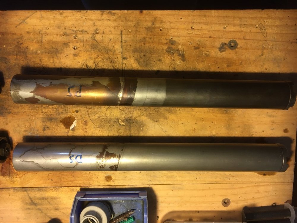

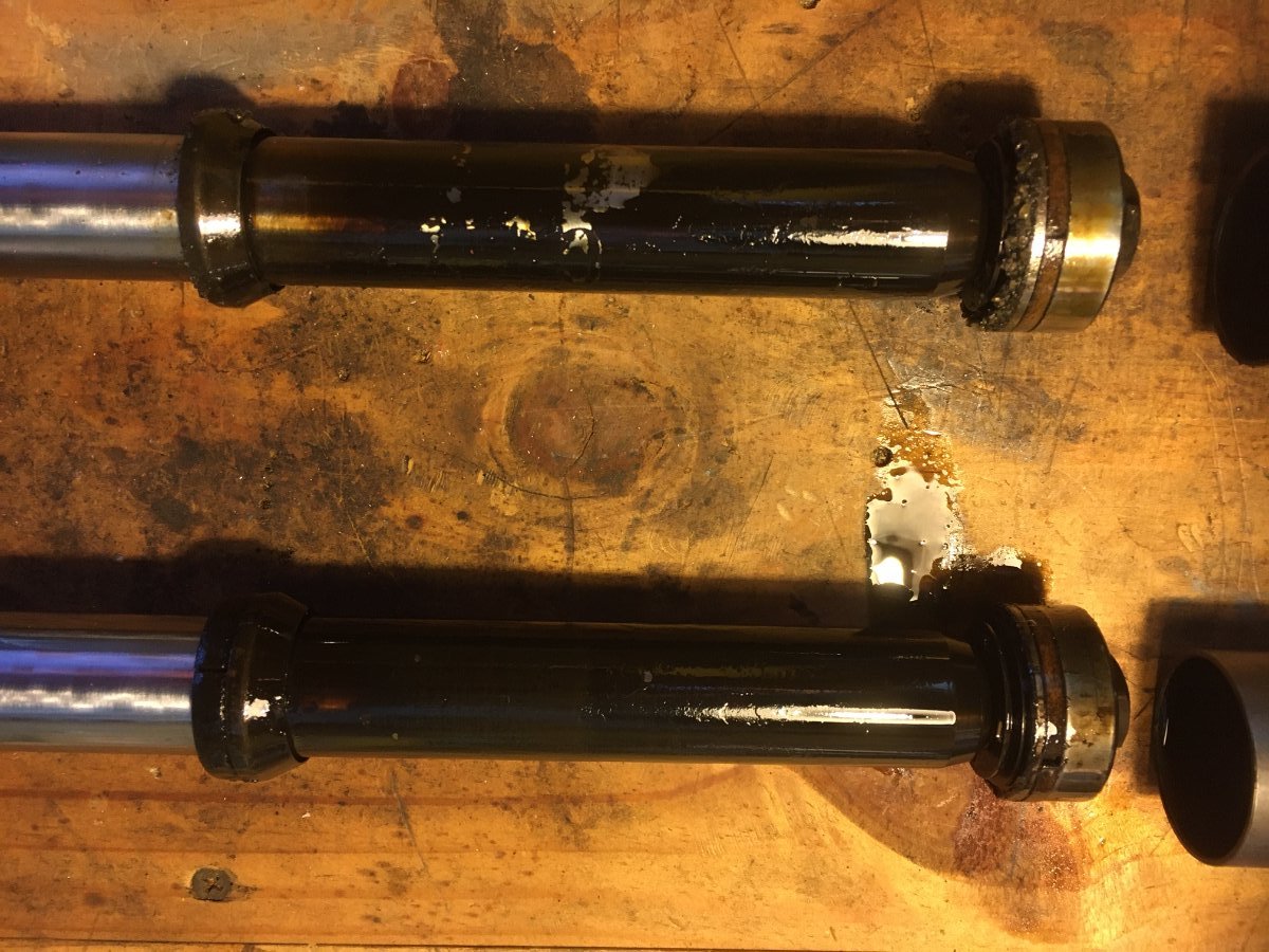

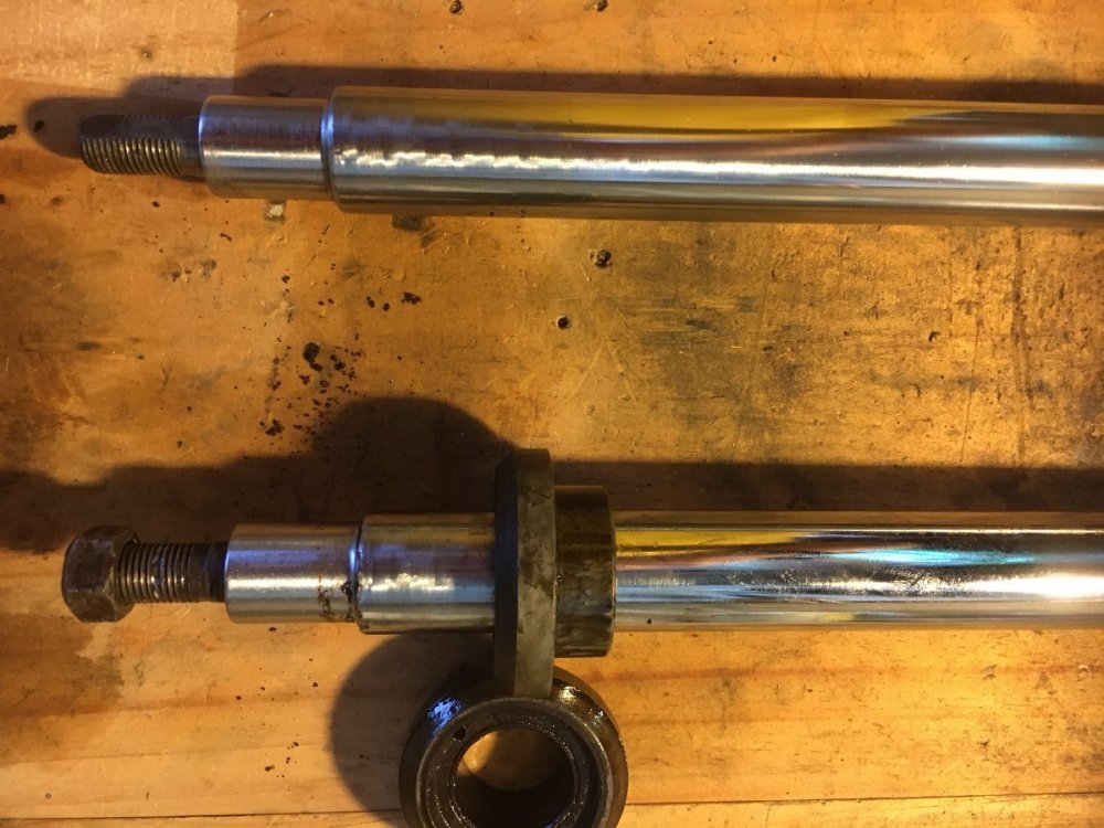

  4. hey everyone so I pulled apart the wet legs I removed on the weekend... see what I found inside! on the DS, seems to be in pretty good condition aside the discoloration on the lower part of the shaft. the PS one seems a little worse for wear with the plastic stopper from the mid part (I guess there purely to keep the shock piston straight in the tube) had completely disintegrated which explains the shattered plastic parts that drained out with the oil! the lower plunger parts has a bit still stuck around it too. but should clean off. despite all this they both still seemed to "work", but I just thought it was time for an upgrade/rebuild. I gotta say I was surprised that these were in better condition than expected. I dont think they have been looked at from birth! now I debate shortening the piston rod to accomodate the lowered springs. my idea was to take about 40mm off the threaded top end, so to move the piston back to it original travel area within the inner tube with the lowered ride height? but will this stop bottoming out? or i just get a set of bump stops for the outside. and yes, i also have the issue that when unloaded, the lowered springs sit shy of the top hat.. about 30-40mm short all good once the car is the ground... just dont get airborne! but I figure taking 40mm off the piston rod may help with this issue too? pics mainly for reference of anyone wanting to see inside these without having to pull them out of your car! but 1 question: does anyone know where I could get the new plastic bit???
  5. what i will mention is the oil was very black and very stinky!
  6. hey guys success in a way... i managed to extract the old dampers and now have fitted the KYB's... on your advice, locky i have not discarded the old "wet legs", if they prove to be serviceable i will refill and replace them again... ended up not being that difficult when i used a bit of slide hammering to get the old dampers out! in any case, its ready to drive again!
