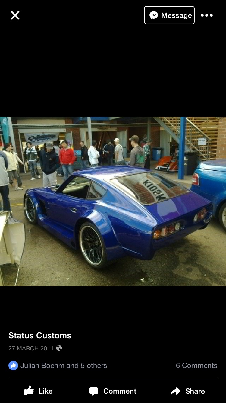

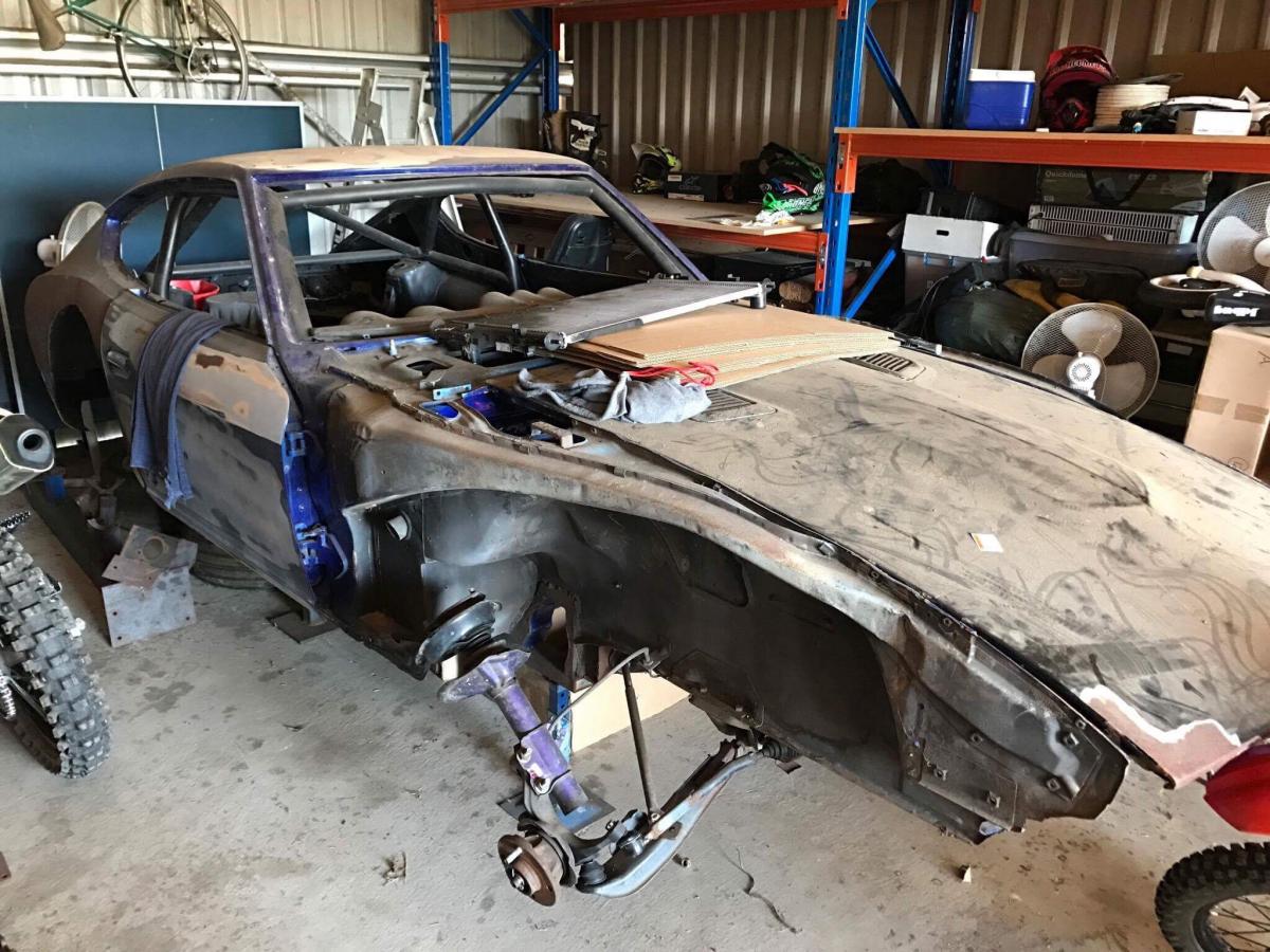

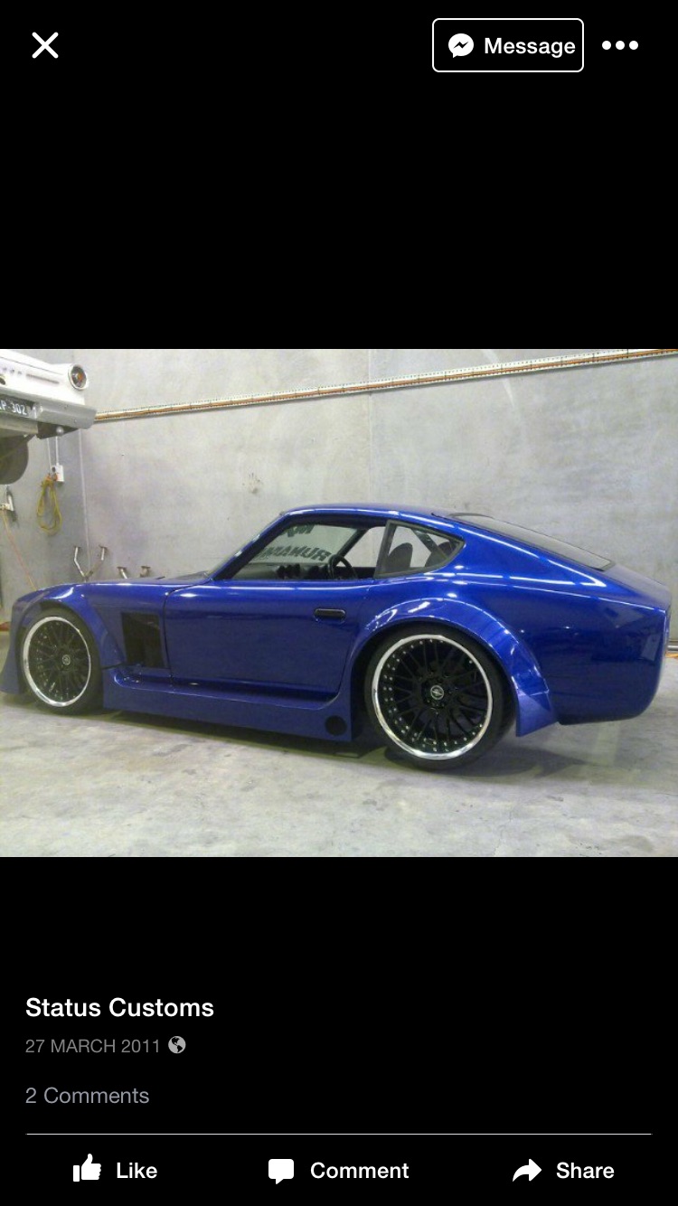

  5. Yes it did have a 2JZ. He also has a 260 2 seater with full gtr running gear in it. It's coming down to my brothers shop in the future for some paint.
  6. It's former glory. Not sure if hatch vents have been covered or has a different hatch. Obviously far from standard.
  7. My brother was looking at buying this off his wife's cousin. He said it has the vents in the hatch so I asked what number it is. Apparently it's No.000000062 The owner changed his mind and said he can't get rid of it yet.
  8. Nah it was purple with no flares. Same wheels. 2.5 years ago I bought my rust free l28 turbo 260 2 seater for around that money too.
  9. This car looks a lot like one that was for sale when I was looking for mine 2.5 years ago. It was on car sales back then. I think it was 10grand then. It was for sale for a long time then.
