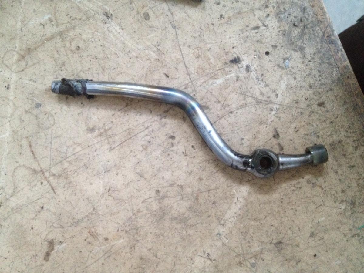

  3. JonZ
    Gear Stick (Manual)
    Here's what is in there at the moment. It has heat marks around the bend in it so it may not be original.
