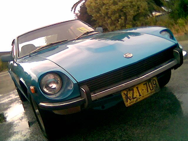

  6. Hi all, I need some help deciphering a problem with my headlights. I'm not electronically minded and i'm learning on the go so i'm probably going to need you to explain this to me like I'm 5. I'm trying to get my headlights working on my '75 260Z 2+2. I started at the fuse box to see if there were any broken fuses, which there doesn't seem to be. My next thought was maybe it's something simple as the bulbs are blown. Before I start taking that apart I figured I'd make sure it's not an electrical problem with the wiring. The rear lights work and licence plate light when I switch them on so it can't be a problem there. My parking lights work (LH only assuming bulb blown on the RH) and i've come to discover that high beam DOES work. However it only works on the RH side and upon checking the LH side its very dim, i can see its on but its not bright enough. What could be going on here? How does high beam and low beam work? Is it stupid to say there are two bulbs in the headlight?? If not what on earth is happening where by I can have high beam but not low? I'm starting to think its part of my overall electrical problem as other things don't work either. Appreciate all assistance
