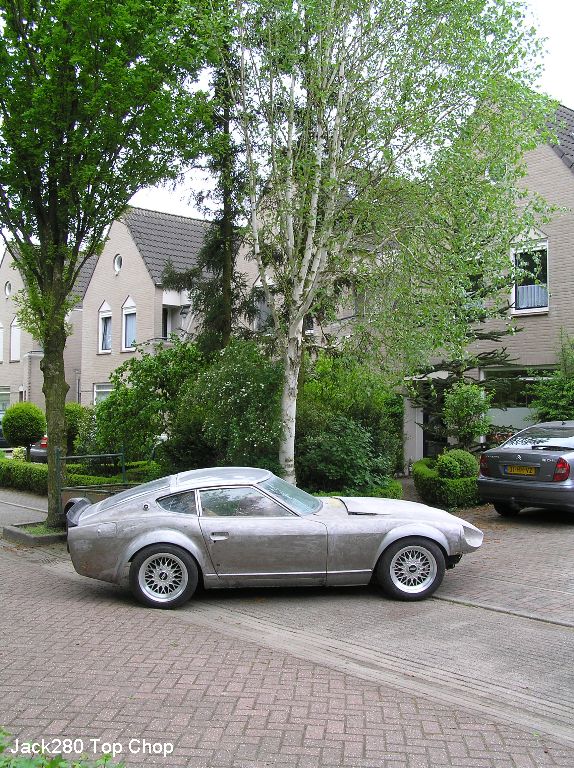

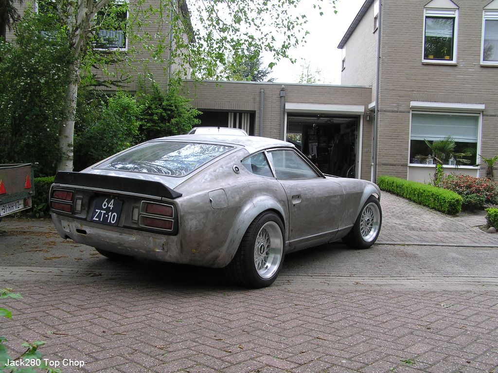

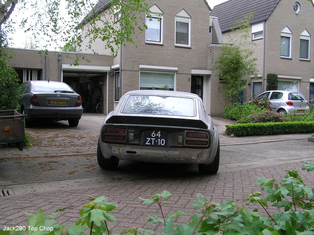

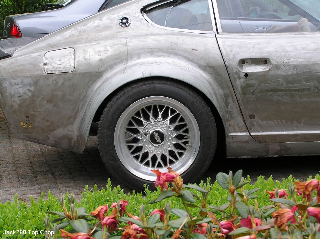

To create this top chop, I had a lot of promlems to solve before I cut the roof.
In that time when I started my plan, I was not able to cut the front windscreen to an other shape. So I dicided to remove the complete window frame and tilted it backwards.
The roof is shortened at the front and the door glass frames are modified to fit to the new roofline. I have now a glass cutting experiment to cut side glass out of the front windscreen from a van or truck since I need curved glass.
I am now working for 6 years on this project in my spare time, and I still need some time to finnish the build.
