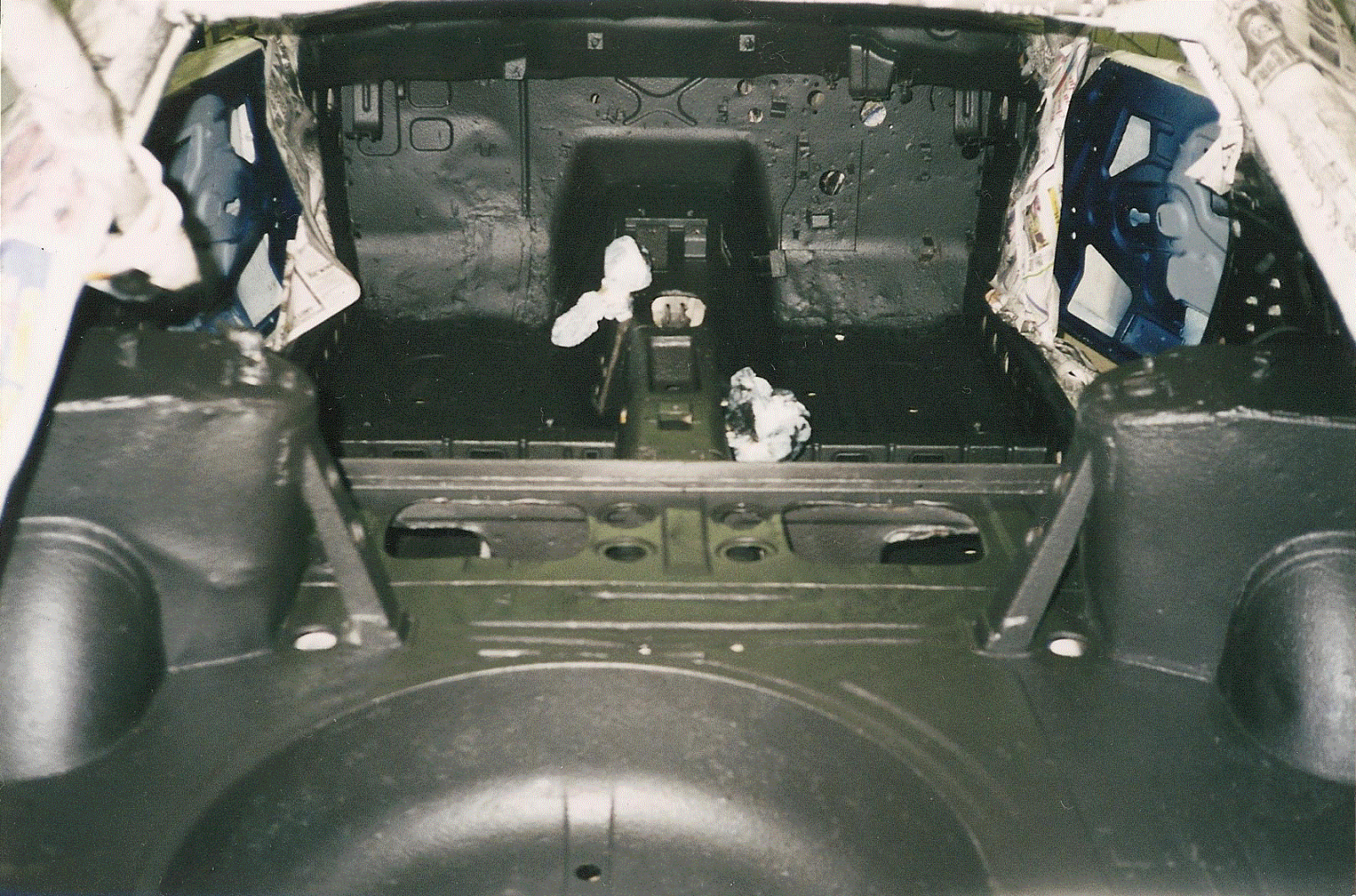

The bare interior
No bitumen sheets to be seen, I'm sure this has lightened the car up somewhat. The frame rail welds are obvious on the passenger side (both sides were replaced). and the tops of the wheel arch have had some mounting points for seat belts included to give me some extra options about holding me in the car. The slag has some sound deadening properties, but I found a light weight fire retardant sound and heat insulator to use instead, which also doesn't hold water.
