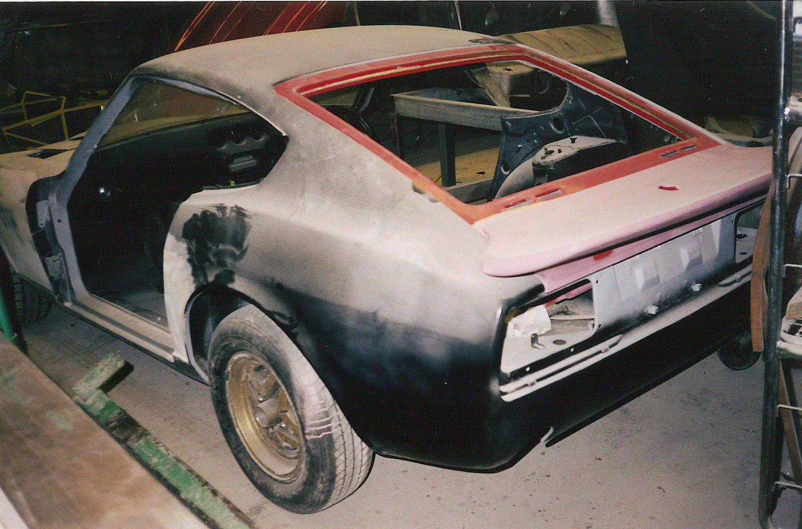

You can see in this picture the black guide coat I used. Standard proceedure, and fun with a long board, I have an air powered long board but the finesse of a manual longboard cannot be beaten. You can see the wing is now fully repaired, I cut out the bumper mounts and welded up the holes for that smooth tail.
