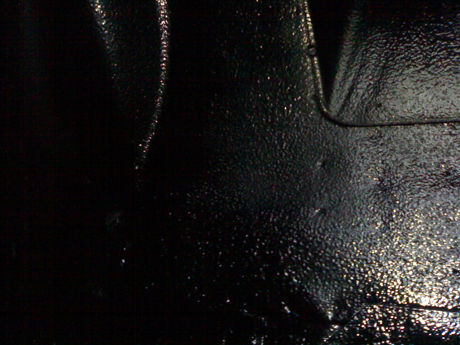

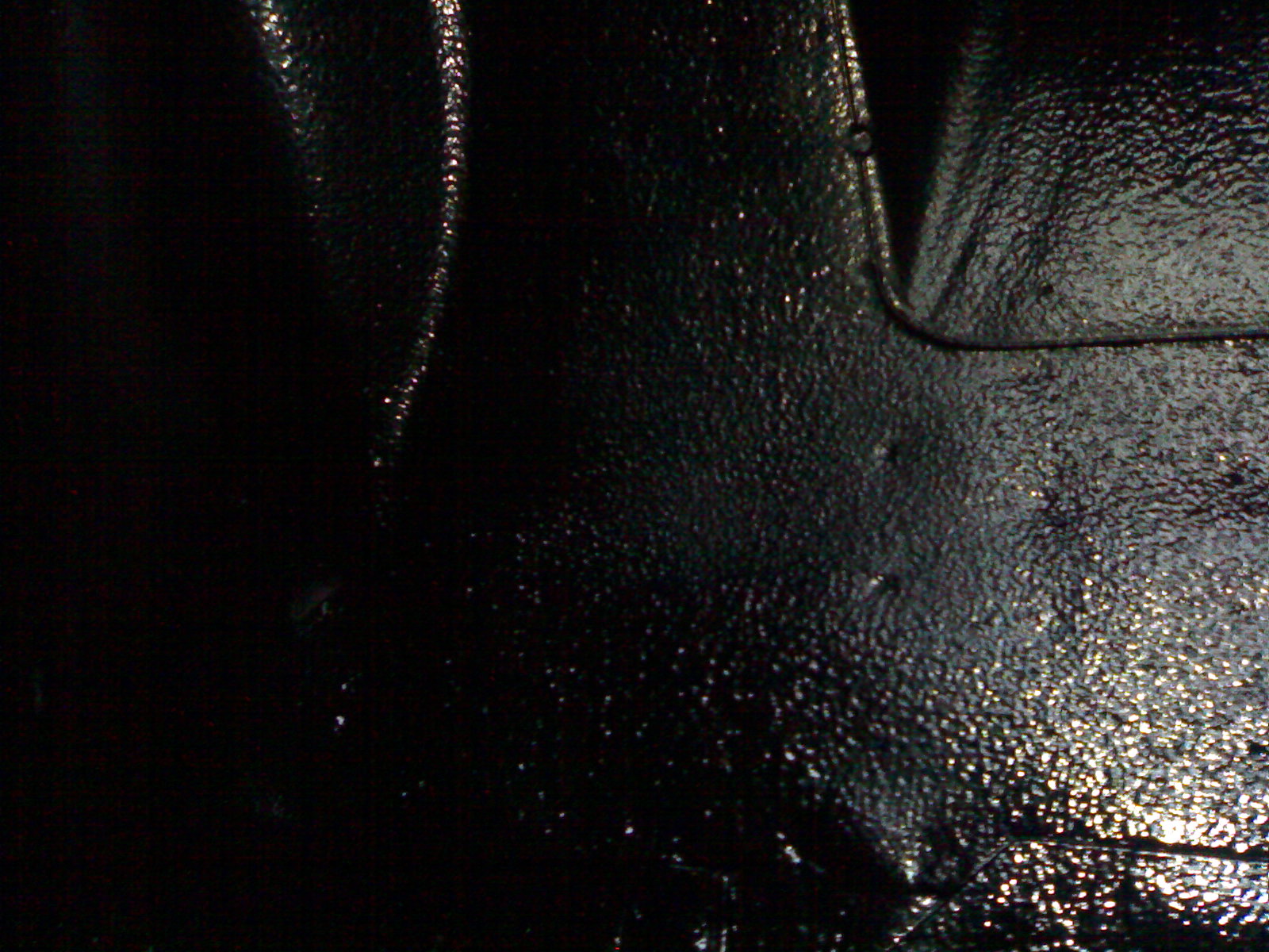

Front Wheel Well
After I completed striping this to metal it was etch primed, schien slagged, black primed and painted black under the car. This is what the whole underside of the car looks like now. I chose this because I wanted the underside to be durable, hide dirt and be easy to clean with a pressure washer. What use is it to have a nice zed if you are afraid to drive it?
