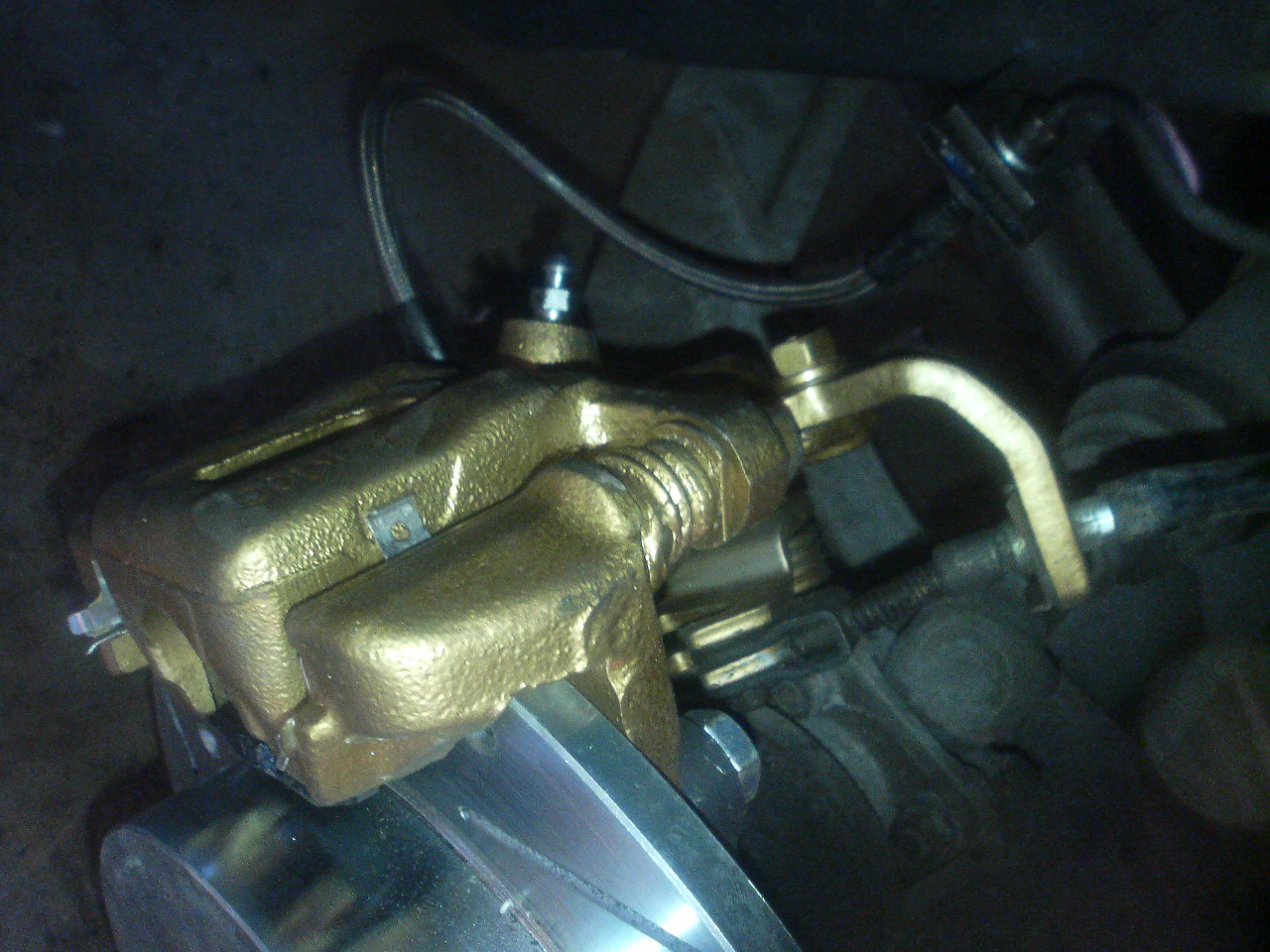

Project 240Z Brake, Rear Caliper installed image, Closeup
A closeup pic of the rear brake caliper.
Note anyone whose going to do the rear brake conversion, be prepared to change/re-kit the master cylinder. 30 yro cylinder won't cope with all the flushing and the rust/impurities inside the lines clogging up the system.
