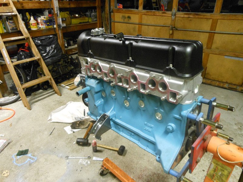

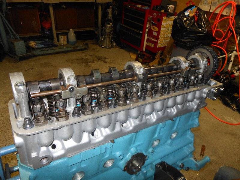

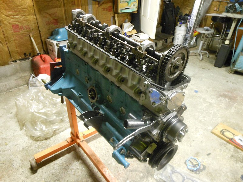

Ok so here are some current pics of the engine as of last night:

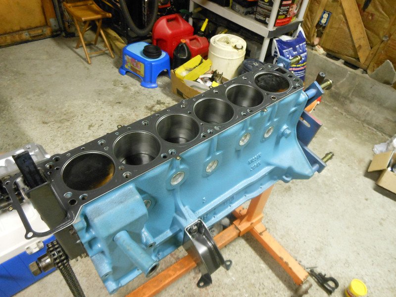

Pulled the head back off yesterday to give a final wipe down and double checking everything. Here is a pics of the lower half of the L30 with the 1mm HG:

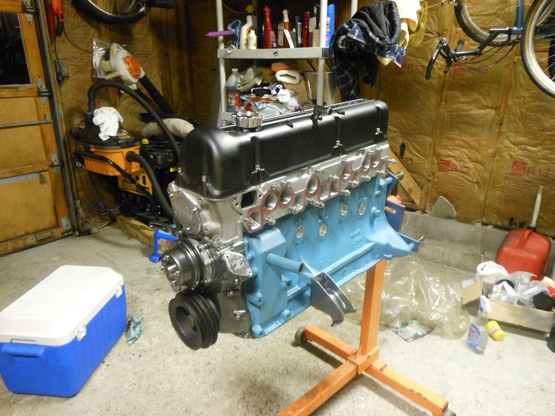

After reinstalling the head with the ARP head bolts - I reinstalled the E31 spary bar just to make sure the cam is well oiled. I am running a 280zx turbo oil pump:

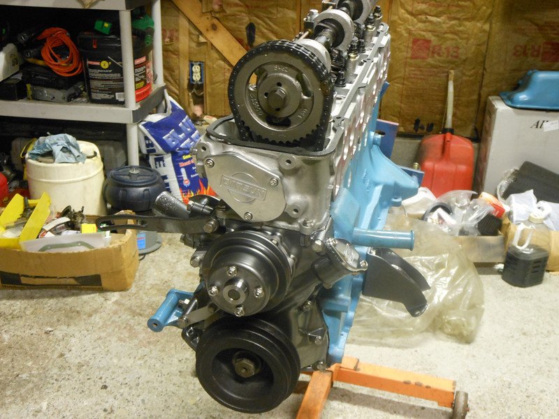

Front cover complete - timing set, all gaskets seal up nice and a must have is a SS bolt kit when putting one of these together. It makes assembly super easy and clean. Also it just pops well against the new parts:
Also added new SS studs and bolts for intake and exhaust:

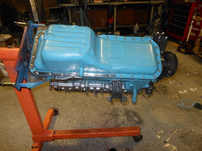

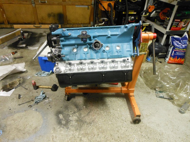

It is nice having a spare engine to steal parts from because I def lost 2 years ago small odds and ends. Next picture shows the engine flipped over and I was getting ready to install that metal shield that goes over the mesh for the breather tube. Def easier to do this with the crank out. Also had to rotate the engine a few times to check clearence, don't want to have to pull the oil pan to fix that later. Also gave a final check to make sure there were no nuts and bolts or just debris in the block after working on it for a few hours. Once that was complete, wiped the block face down where the gasket would be and went to town sealing it up!
So the one major item I am missing right now is.......a dip stick tube! Machine shop removed mine and I have no clue where it is now. The spare engines tube got messed up when I tried to remove it. Progress is being made and hope to have the engine completely sealed up in a week. Waiting on header I bought from a Hybridz member and then I can mount the Weber 45s and see the BIG PICTURE!
Next -
I am hoping to have her fired up in a few weeks. I will take the time to refresh the engine bay of the 260z - major while I am at it.  ;D
Can't wait to see the pics once the carbs are mounted as well! You're lucky to have a gf that is into cars...rather than complaing about it taking up space, she's complaining about no horsepower! That is the complaining I'd like to hear!

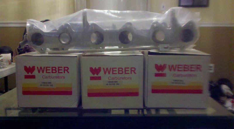

I am going to get the intake mannifold powder coated this week, it will make it much easier to keep clean.
