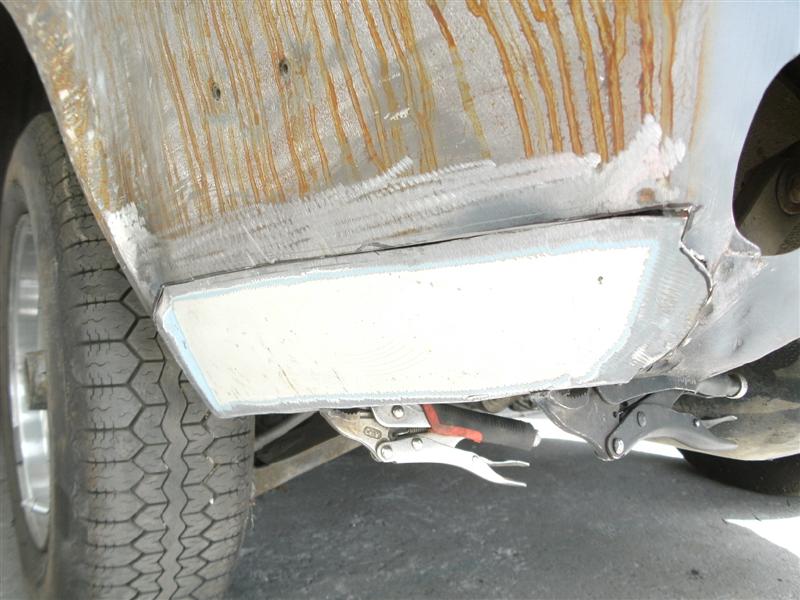

It has been stripped down completely 10 years ago but reassembled temporarely as a rolling chassis
It looked OK especially as the floor has no rust other than surface rust but after removing all the bog from the rear.... well you can see by the photos!
The only major rust forward of the doors is the air intake. It will have to be cut out and rebuilt.
I priced a pair of rear lower quarter repair panels from ZCarSource fro $60 each but they wanted $221 to post them...no thanks!
So it looks like I will have to make them myself.

I am in the process of making a 'forming jig' to make the panel pieces myself.
I will post a photo when I finish the jig.
I will only post a photo of the finished piece if it looks good!!
