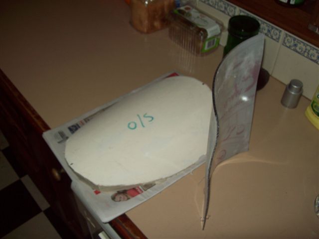

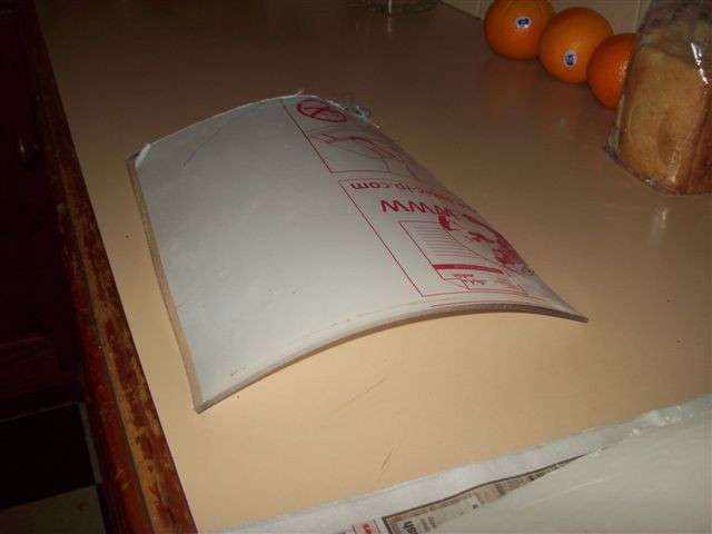

I don't have any dramas shaping Polycarbonate for headlight covers!
You would probably require a industrial oven to warm a sheet the size of the rear window.
