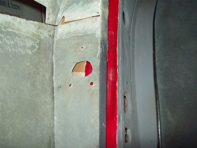

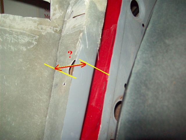

I trying to fit modified fibreglass doors but I have no trim or weatherstips as yet. I wonder if someone can give me a measurement the inner door surface should be from the seam around the door opening (see photo). The measurement near the latch would be great. Thanks.
That measurement might be different to your glass door Peter if someone measures their steel door. Wouldn't it be more to do with the outside lining up flush. Weather strips make a big difference too, once installed.
...Wouldn't it be more to do with the outside lining up flush...
Tim - While the fibreglass door are replicas on standard 240Z door I've chopped 100mm out of the their height and the outer skin profile I'm creating is different to standard. At the moment I have no reference points other than the spot welded seam around the door opening.
