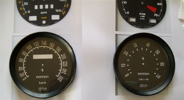

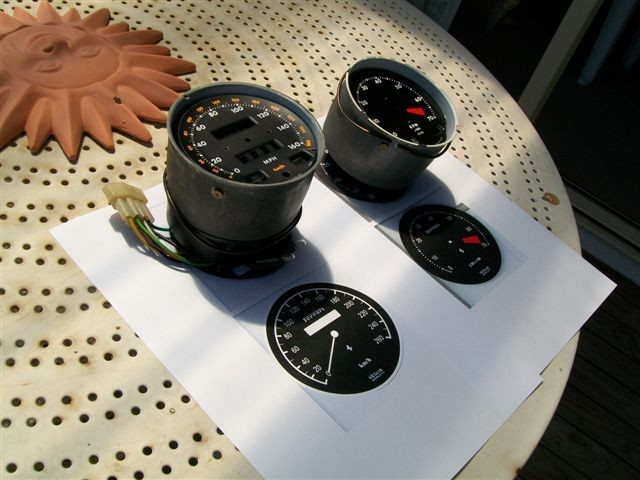

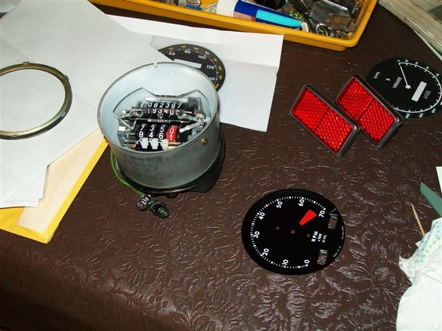

If you specifically want Autometer gauges I can't help but if you simply want different gauges you might want to consider making your own dial faces. I am making my own fibreglass dash with Smiths gauges out of an old Jag and I have made my own dial faces.
I just scanned the Jag faces and, while keeping to the calibration marks, made the images I wanted on MS Word. Print the new faces on photographic paper and either stick them on the old faces or make new blank sheetmetal backings and stick them on. It works on the 50mm gauges just as well.
I dare say you could make new faces for the Datsun gauges.
