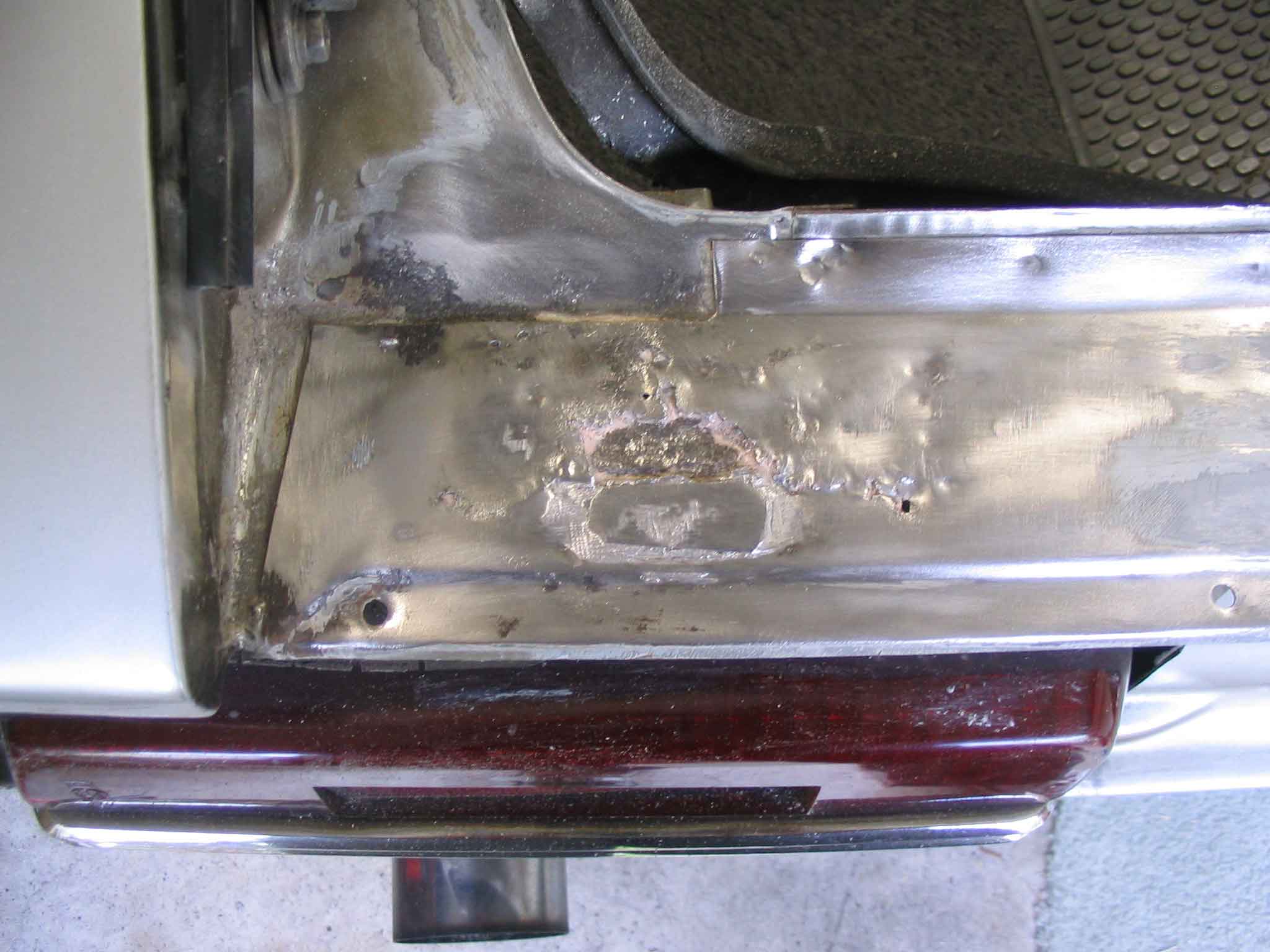

After some work on the panel across the back of the hatch, the one where the lock comes through I have decided I should replace the entire panel and clean up and POR the metal underneath.
What is the best way to break all the spot welds ?
Is it just drill them out and patch the holes later or is there a better idea ?
It got much worse underneath after I peeled up the end piece in the picture.

device called a spot weld cutter - has a small drill in the end, and then a solid boring bit behind that (or more like a holesaw if its a cheapo one). Have tried drilling them, takes absolutely forever, and you need a large supply of drill bits. Have shattered a blade on the first weld I tried to drill with the cheapo holesaw cutter, no good.
The solid bit, however, goes straight through, and the small pilot drill in the end is replaceable on the one I have. Got it from Snap-On for around $35, from memory.
If there is paint still on the spot welds, it helps if you heat it up (ie oxy or gas flame) and then wire brush. this helps you to see them... :)
I normally just use about 8-10mm sharp (new) drill bit. go slow and it should last as long as you need.
