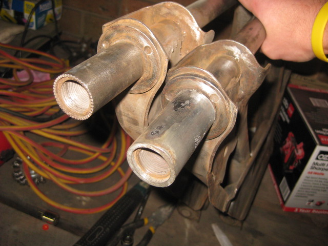

I've got a pair of 260z rear control arms going on my 240z but i've noticed on one end of each arm there is a metal sleeve on the part where the bushing slides on, has anyone seen that before?
Looks like the inner metal sleeve from the original bush is rusted on still.
Soak it in brake fluid for a few days or heat it up with a torch and it should come off
