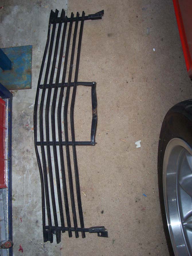

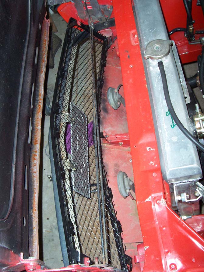

Moderators Zedman240® Posted January 25, 2010 Moderators Posted January 25, 2010 Here's a couple of quick pics I took of the grilles I have. First poor one is of the 432 grille in my 240; if you can make out the lower left and right hand brackets on the chassis don't match with the grille. The two upper and lower middle match without any issues. Other pic is of a 260Z "venetian" grille. Quote
RB30X Posted January 25, 2010 Posted January 25, 2010 Here is a 260Z as Dimitri posted above fitted to a 240Z. Do you have a front on of your mesh grill? Does anyone have a pic of an original solid 240Z grill? Quote

Mr Camouflage Posted January 25, 2010 Posted January 25, 2010 Better treat that rust on the inside leading edge of your bonnet, and splash some paint on it Zedman Quote
Moderators Zedman240® Posted January 25, 2010 Moderators Posted January 25, 2010 Better treat that rust on the inside leading edge of your bonnet, and splash some paint on it Zedman Hehehe...I know... I spotted that a while ago when I first started the conversion.. That's what happens when you get monkeys to do panel work... swapped a mean injected L28 for that paintwork. Who got the shiver end of the stick? Quote
GV260 Posted January 28, 2010 Posted January 28, 2010 My 432 grill is the same as Zedman's (Dimitri's) and fitted likewise re the top left and right and middle bottom matching up to the chasis brackets. The bottom left and right brackets were about an inch out. I made up two little alloy brackets to join to the grille, painted black to colur match it. Quote
