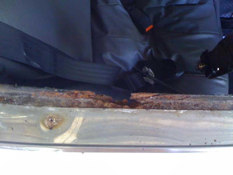

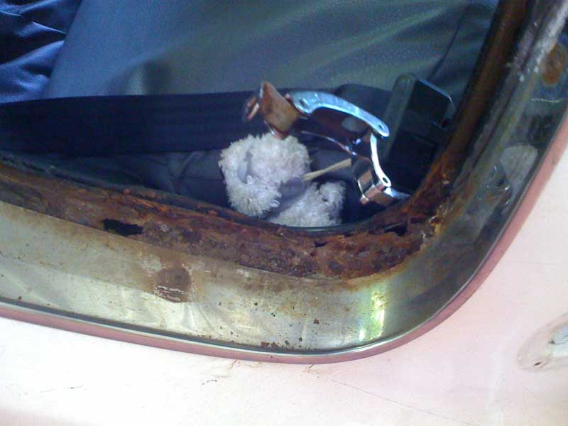

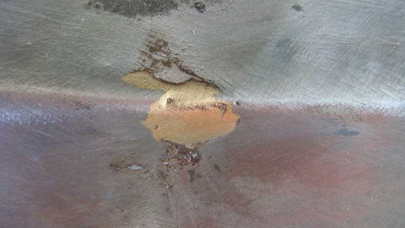

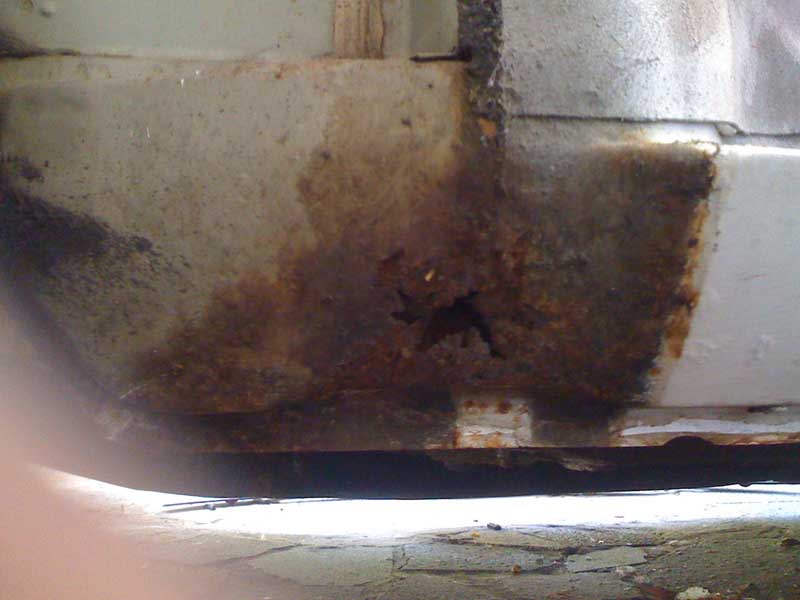

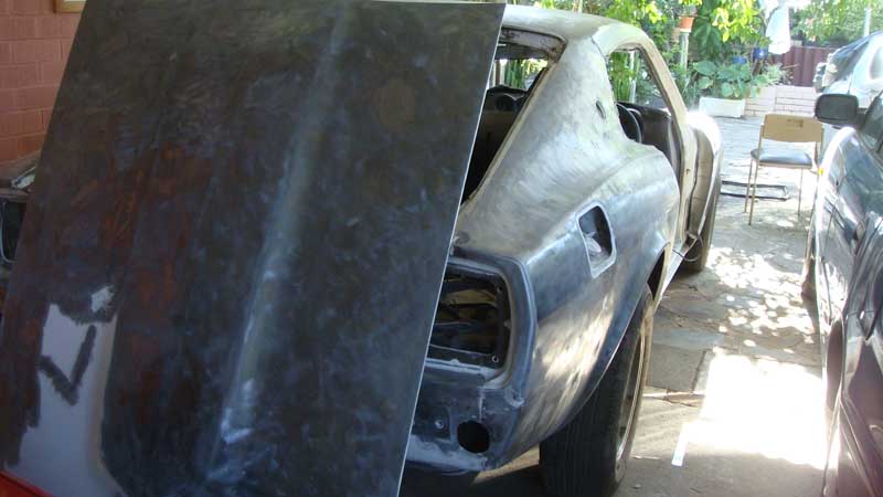

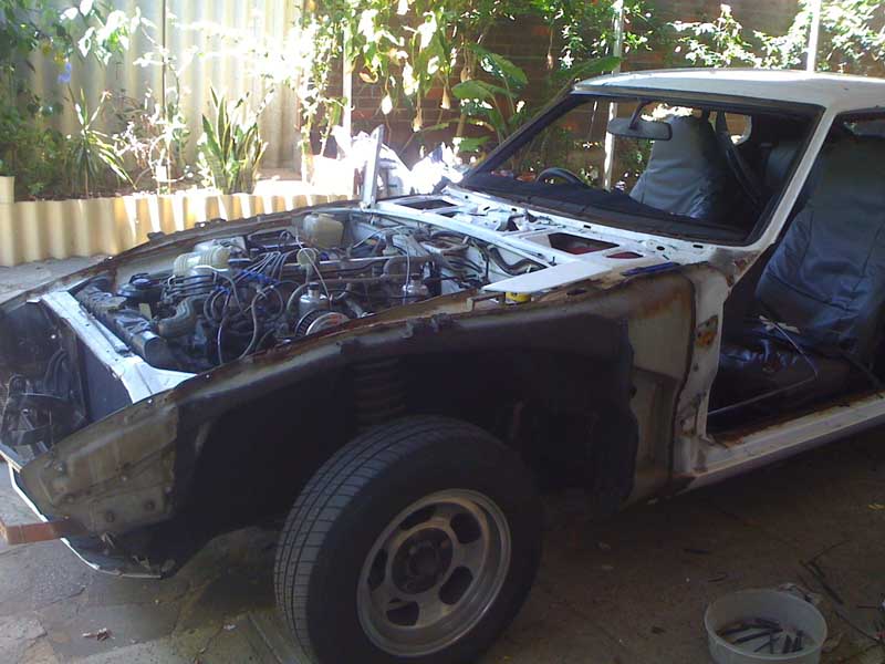

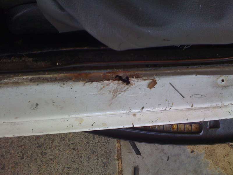

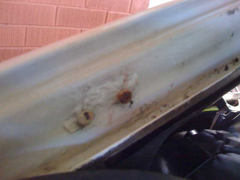

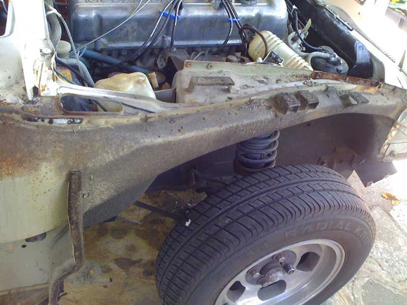

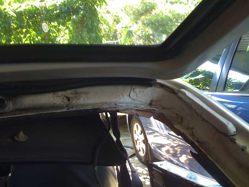

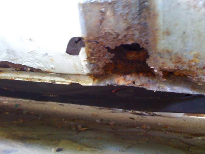

I took the plunge today, cant stand those bubbles and bog areas any more plus my car needs a new paint. So with lots of swearing and sweat I managed to strip off pretty much of its cloths. Found some awesome rusts behind the fenders near the wheel arch, some underneath the rubber seals at the rear quarter windows....

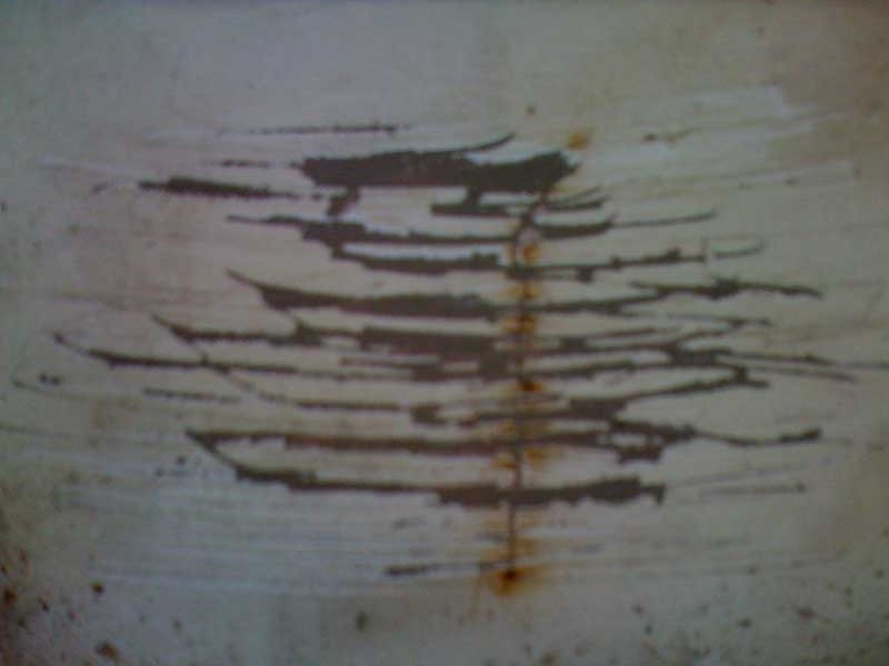

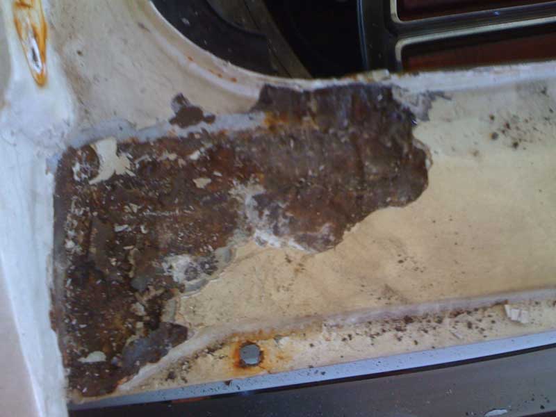

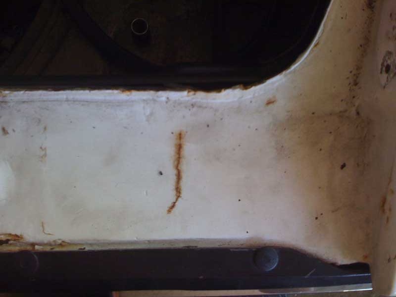

More pics of the lovely FeO, gotta love rusted bolts that just snap in half when you try to screw with it...and the paint-over just made the whole process even worse. I had to chainsawed-Texas a lot of those bolts, not fun.
Just a word for anyone whos planning to bog their car with out the rust treatment first, DON'T DO IT. Found heaps of rust underneath those bogs...now where did I put that disc cutter?

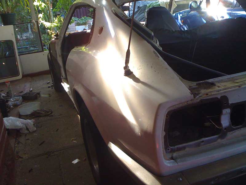

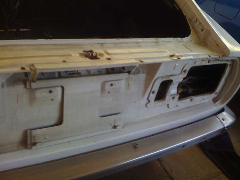

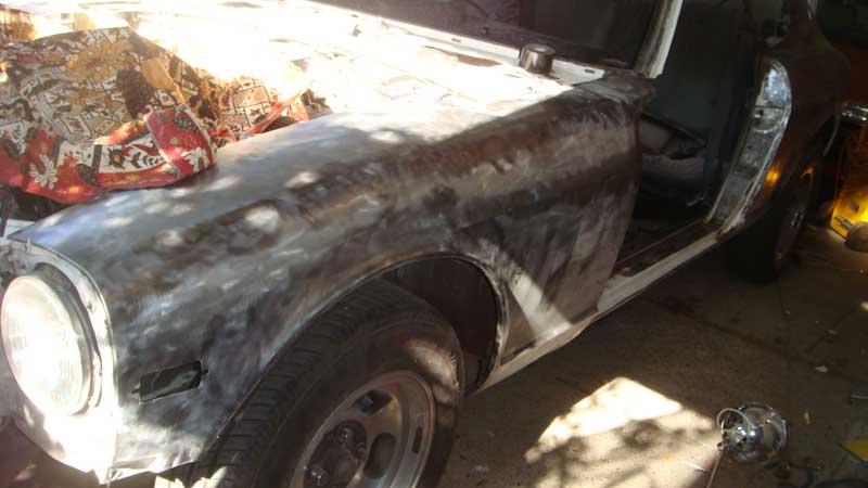

Rest of the car is in good shape, I do have the suspicion that white is not the original colour, scratched some paints and I see burgundy underneath:rolleyes:...confirmation will be made when I start stripping the paint off.

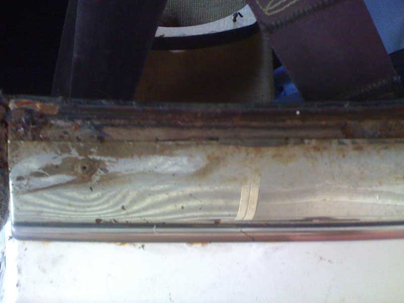

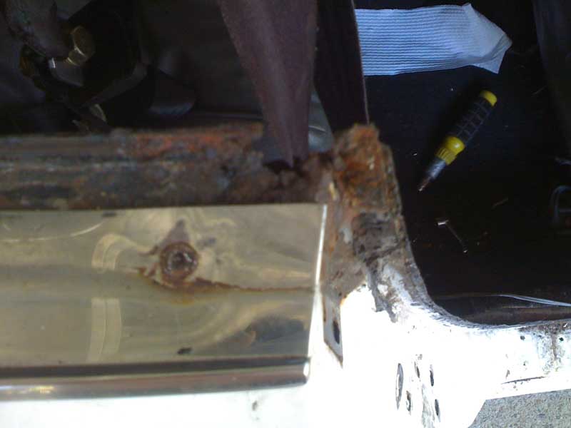

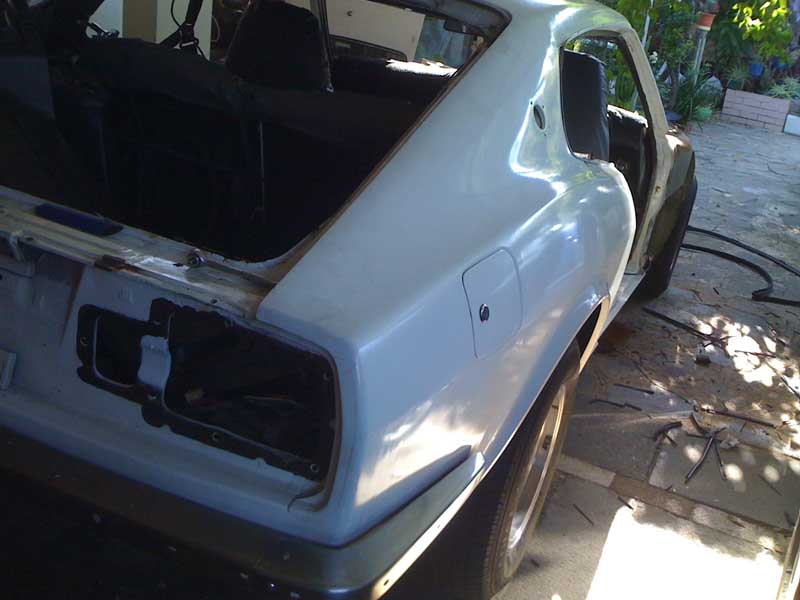

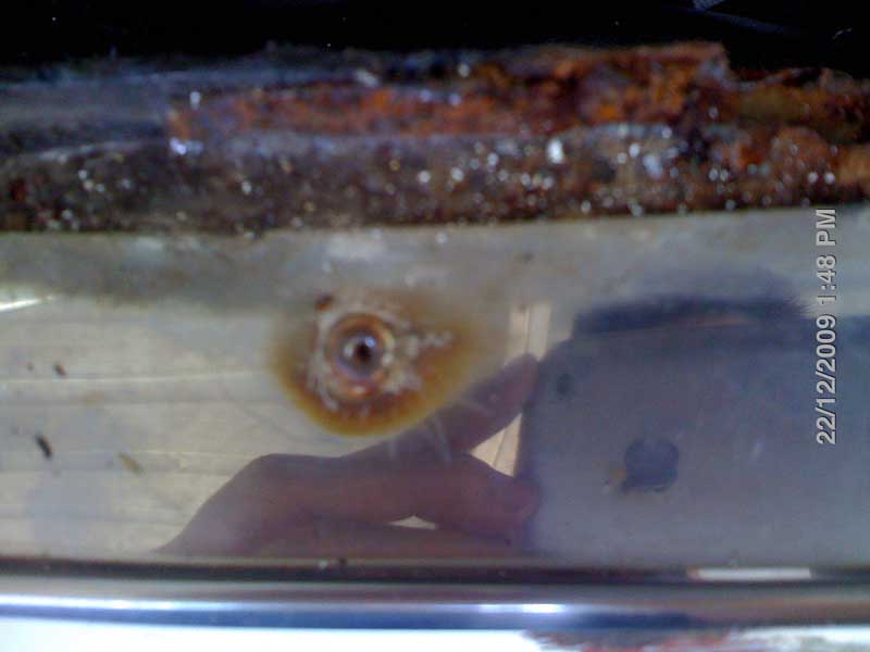

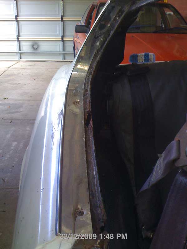

I need some tips on how to remove the chrome plate behind the rear quarters, it looks like its held in place by 3 pins, tried to pry it but it doesn't budge. Should I Hercules it?
..and more pics
..and more pics

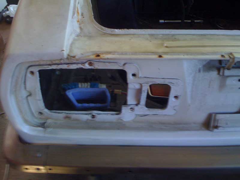

What that thing? http://www.viczcar.com/forum/index.php?action=dlattach;topic=6236.0;attach=12903;image
They should be held in with plastic rivets similar to the ones used to hold the interior panels.
You should be able to punch the center in and all the way out, then the whole clip will come out.
A picture might make it clearer.

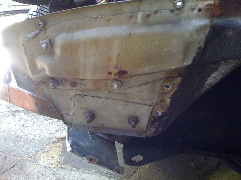

My bad, its not behind its AT the rear quarter windows, they are metal pins. It seems that they're not meant to be removed..but I bet there are more surprises for me hidden underneath it  :'(
They are pop rivets by the look of it. Thought they were supposed to be screws, the 260Z I wrecked had them screwed on.
You will have to drill the heads off them. Find a drill bit thats just a bit bigger than the hole in the middle and drill until the head separates from the rest of the rivet. A 3mm drill should do it.

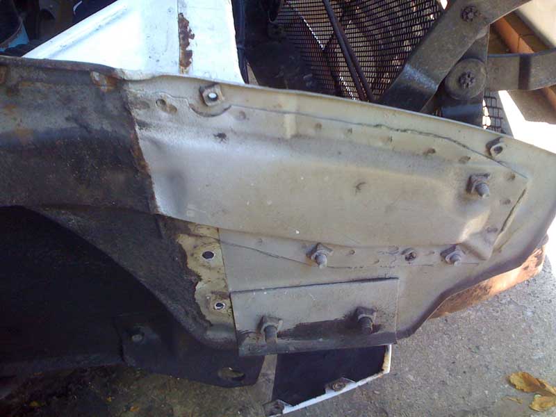

Here is a small update on the progress, anytime now. There seems to be a copper weld near the rear quarter, interesting.

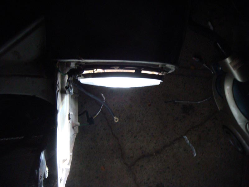

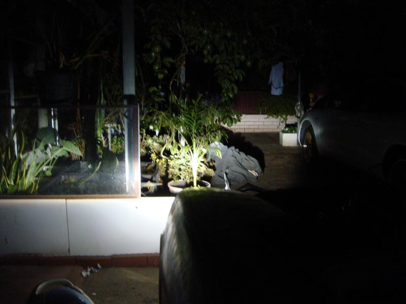

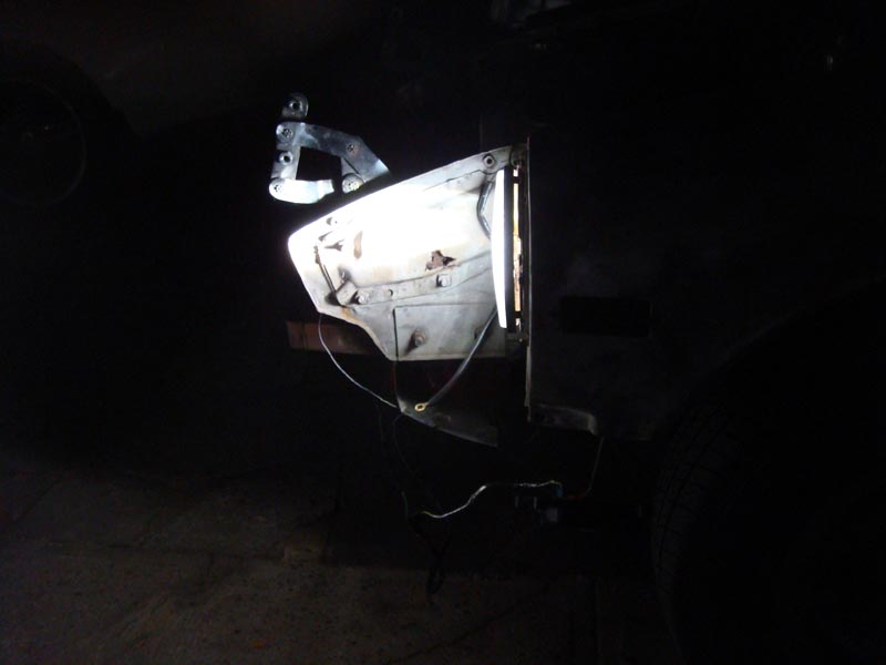

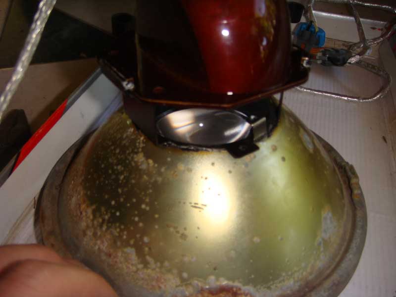

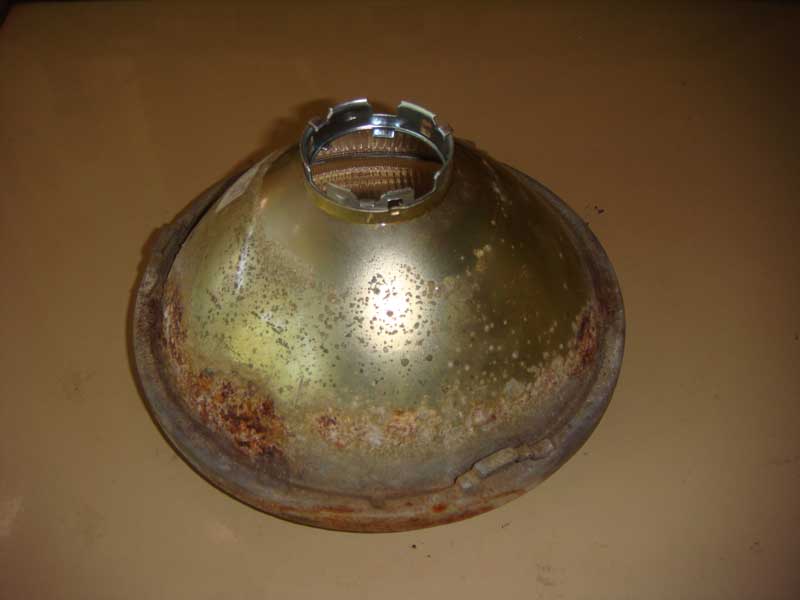

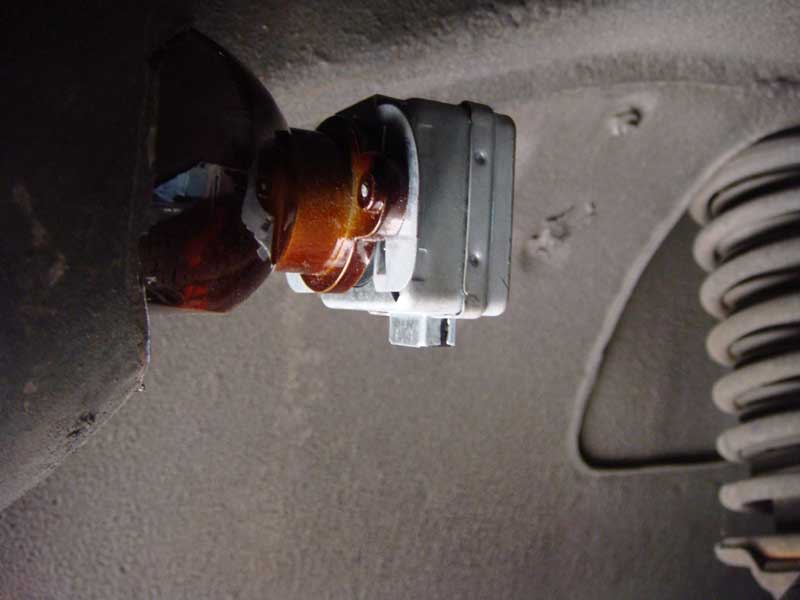

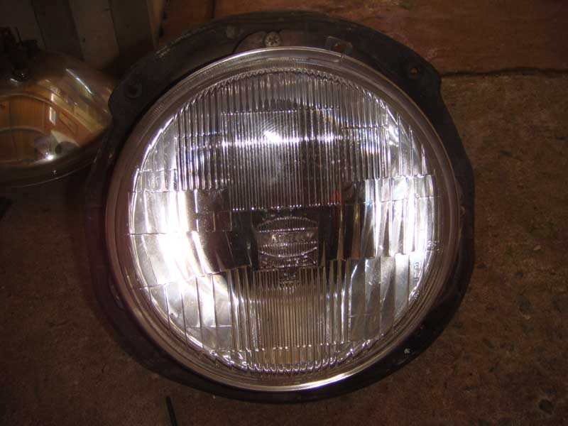

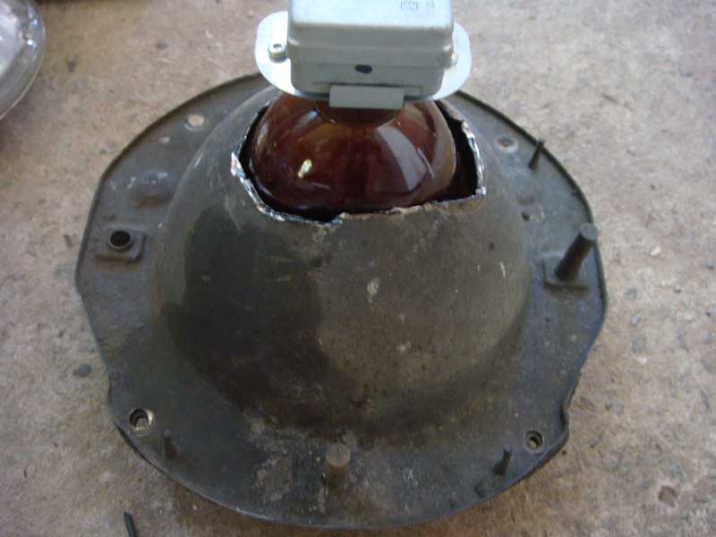

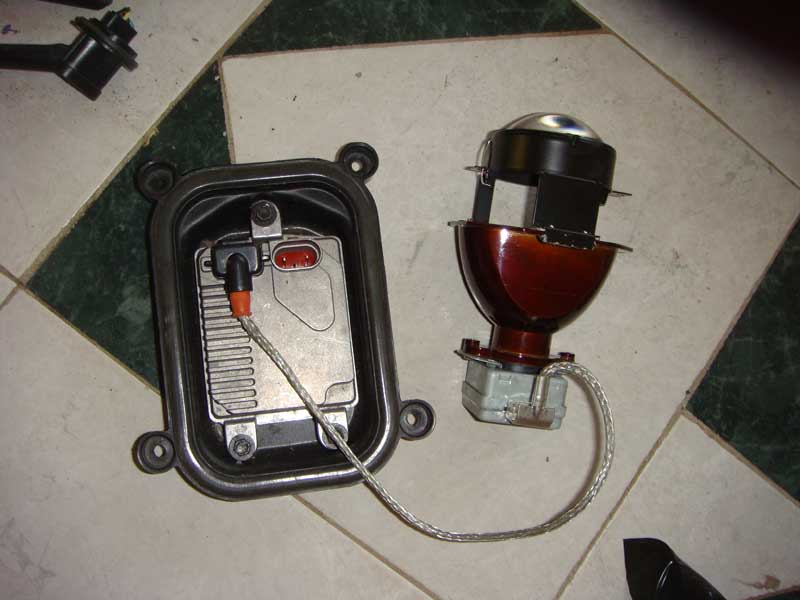

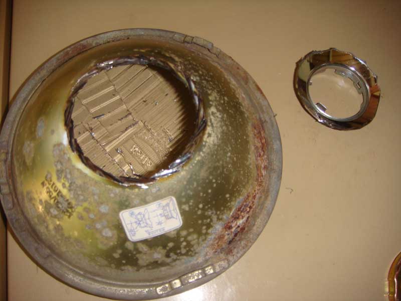

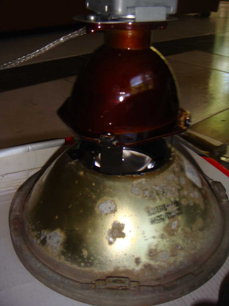

Taking a break I went ahead with the projector conversion, found a pair of OSRAM HID projector from a previous project so I done a test fit on one of the headlight housing.
If you are competent with angle grinder, this will take you about and hr to finish and remember to upgrade the headlight harness while you're at it.
