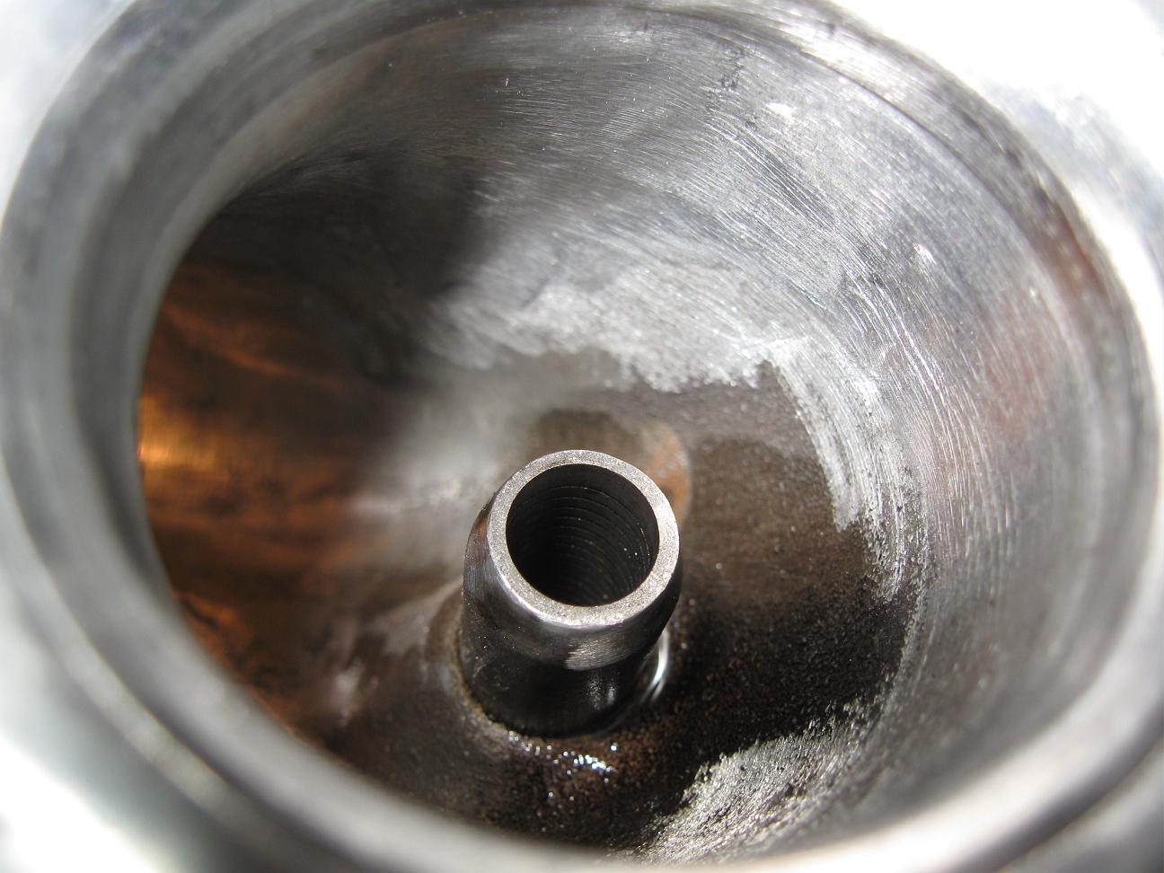

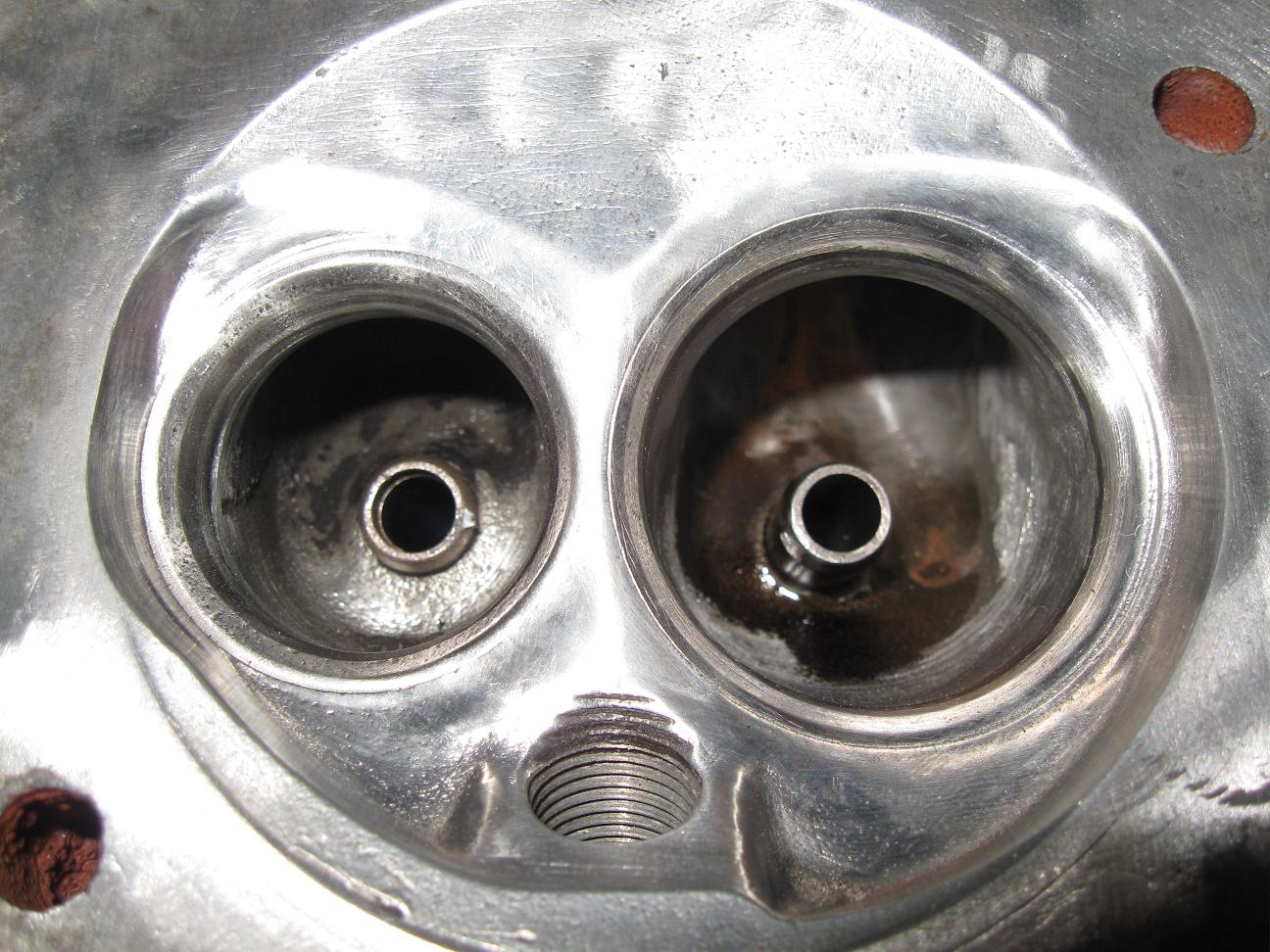

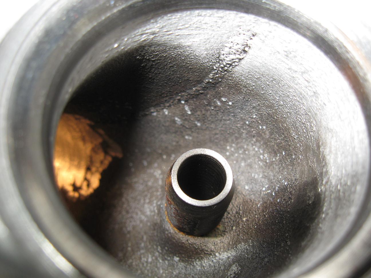

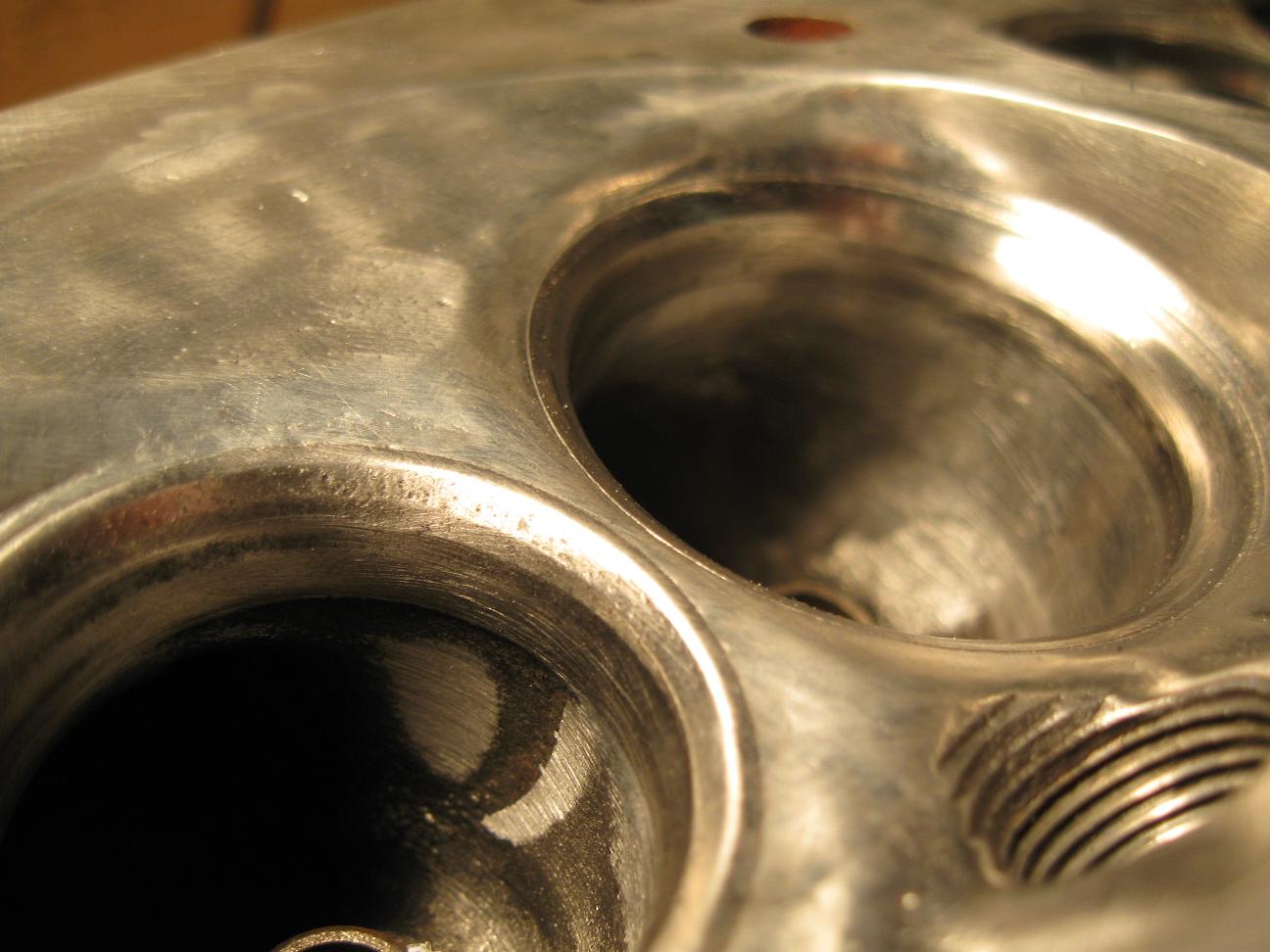

ok so starting to clean up my N42 head, dam casting marks.
This is a VERY rough first pas so please only positive criticism if possible.
So i have unshrouded the valves and cleaned up the port a little but ran out of small sanding discs so need to wait till next week

Dont make your surfaces super smooth, some texture is a good thing, it allows the air to separate from the walls, keeping a higher and smoother velocity through the runners.
I dont know how feasible it'll be, but it may be worthwhile shortening and narrowing down the valve guides where the protrude into the runners.
