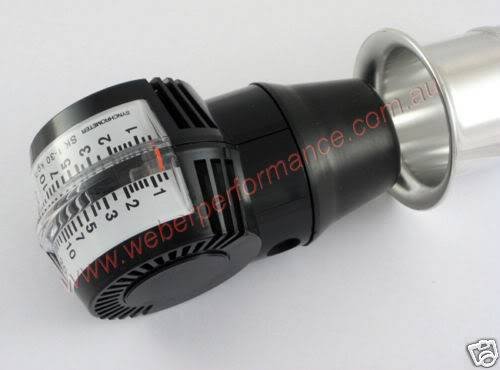

Hooray, my 'Multi Carburettor Syncronising Tool arrived today, so I skip out to my shed like Dorothy along the yellow brick road, fire up the L24 and hello, it doesn't fit so I have to remove the trumpets ;D
After trumpets are removed I test each carb with 0% throttle, then again with small throttle opening. I basically got the first carb to flow to 2 then recorded the second carb of each pair. The results aren't to die for.
The figures I'm referring to are the flow incriments on the tool.
