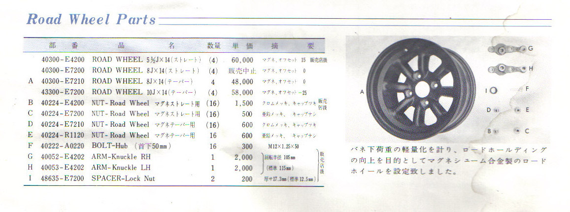

in japan there was an option for 14x8 and 14x10
i've never read anything that said it had to be availible in australia...
if you search 'sports options' on classiczcars you should be able to dig up some info, atm i only know where my copy is at work, this is the best i can find on this computer
This was my exact line of thinking :D
I'm hoping to find a brochure that lists all of the available sports options, that way I can use the width of the zg flares and anything else that suits my needs :)
search around on classiczcars as there are a few pages of the brochure scanned in on that, if you have no luck get in contact with allan (hls30-h?)
apparently the brosures come up for sale every now and again on ebay, but are getting expensive
So basically with the 14x10s it will work out I have great track as well?!
original factory track 14x5.5              1345mm rear 1355mm front
With optional wheels 14x10 -25 offset 1395mm rear 1405mm front
