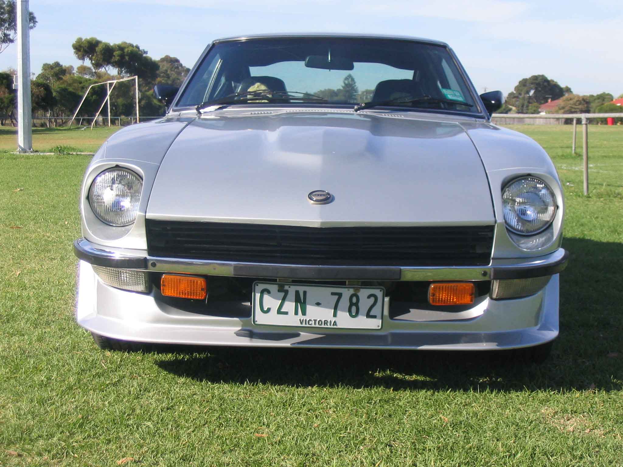

warrenz Posted June 8, 2006 Posted June 8, 2006 Hi Here is a different version of the bumper mounted indicators. I though the ADR's were changed as of 1st July 1973 specifying that indicators had to be orange. Hence the last lot of 73 240's had the bumper mounted orange indicators fitted to comply. The 260 that followed had the combination orange indicator and white parking light. FWIW Warren Quote

sjcurtis Posted June 17, 2006 Posted June 17, 2006 My 73 Zed did have the front bar mounted indicators and the front lowerbrow lights with a single fillement bulb, Wires taped back for indicator wires to the lowerbrow lights as per the change. No indication on mine of a modification to include brow lights to a blank brow panel it looks all factory to me. I have to agree with Warren Z, I think this change was ADR driven. My question above the bar or below the bar for standard I think above. MY 2C Steve Quote
NR240 Posted June 18, 2006 Posted June 18, 2006 My 73 240Z was identical to sjcurtis. I had to source earlier parking light units with 2 globe inputs, as i converted mine to the earlier 240 setup. Mine had the indicators mounted underneath the front bar. I know that the english cars were mounted above the bumper, but not sure with Aus spec 73's. Quote
sjcurtis Posted June 18, 2006 Posted June 18, 2006 I just had a look at my front Bar and the factory holes are under. I have 4 holes, two after market (read rough) on top, and two with chrome in them (pre-drilled) below. Also My guards are original with no repairs for the removal of guard indicators (Euro spec for UK). I agree with Zedrally on the diversion of UK shipments to AUS, but I believe they were the earlier Zeds built with guard indicators and lower lip indicators prior to the UK mandate on indicator hight that forced the production change for the UK spec. This forced a market change on NISSAN or re-work of whole shipments waiting to move. This would also explain so many people thinking thier pride and joy had suffered damage of some kind ie guard changes, too later model stuff with guard indicators. My 2C Steve Quote
warrenz Posted June 18, 2006 Posted June 18, 2006 Mine is pretty much standard and they are on the underside Warren Quote
Jimbo Posted June 18, 2006 Posted June 18, 2006 My 11th Month 1972 has the orange front indicators mounted on top of the bumper... Jim Quote
