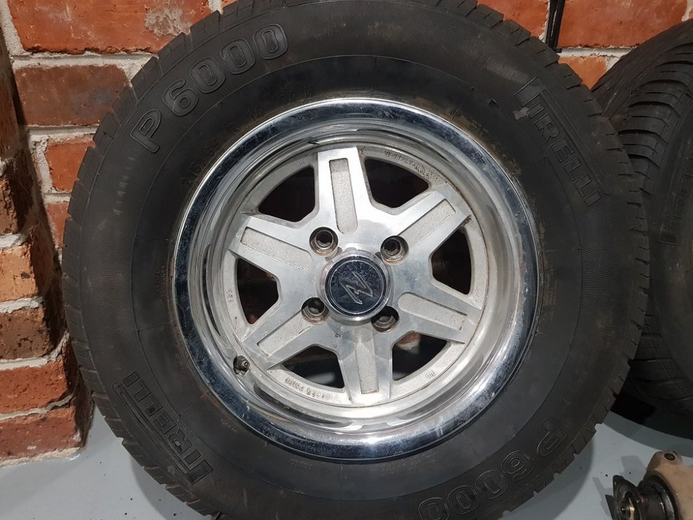

My Zed came with 280zx 6 spoke wheels.

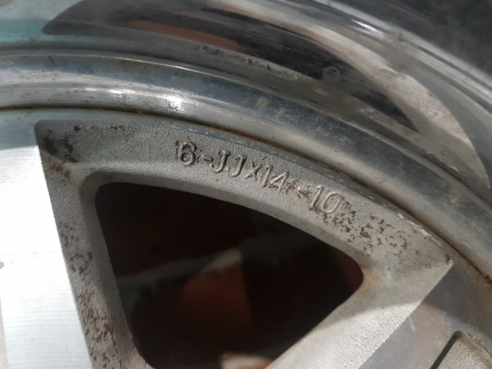

All the research i have done says they should be: 14x6 +12
am i reading these marking wrong: In these photo's it looks to be 14x6 -10.
So is that a "minus" 10, and the rims are negative offset or is it just a "dash" 10. and they are +10.

So if my 280zx rims are +10, no problems, the longchamp's will essentially be 11-12mm wider either side. pretty even. However if the 280zx rims are a negative offset,  they will be sunken in 10mm more than they already are, and be about 30mm closer to the shock. I'm running standard 260z strut housings which sit alot lower than a 240z apparently.
